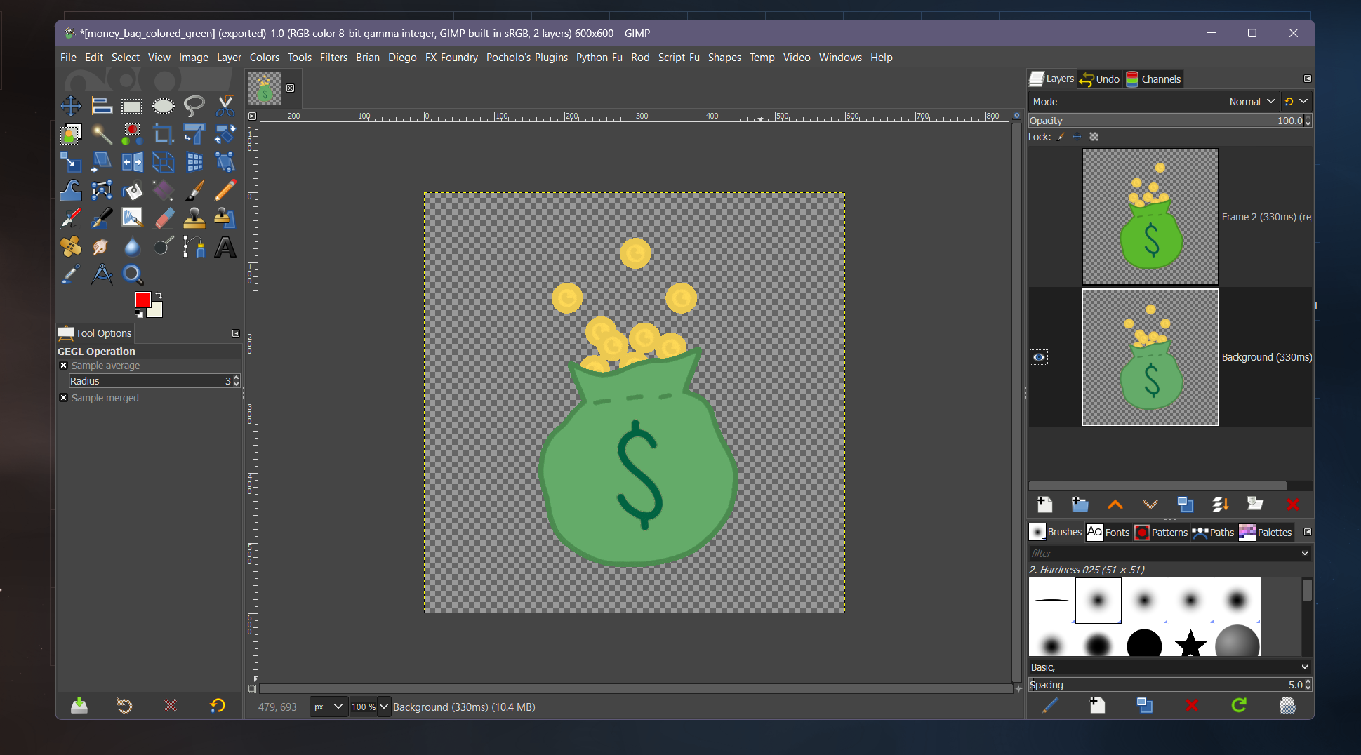

I opened this gif image without changing the image mode.
I made the color edit by selecting the bag and using "Colorize",
then exported the image as a gif.
The gif image dialog opened as usual and export was made as a gif without issue.
Not sure if this will be helpful,
but this is what occurred when I tried coloring part of a gif image.
