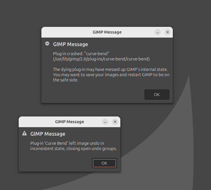

Hello,
Does anyone know why it crashes suddenly?
I want to use it in my script-fu
And when I started the GIMP from a terminal it gives me this error:
/usr/lib/gimp/2.0/plug-ins/curve-bend/curve-bend: fatal error: Segmentation fault
 Post subject: Re: Plugin-curve-bend
PostPosted: Mon Dec 30, 2024 2:54 am  (#2)
Joined: Apr 11, 2024
Posts: 314
Possibly because the parameters that you pass to it are not correct.
PostPosted: Mon Dec 30, 2024 4:40 am  (#4)
The first thing I would try is define flat lines, just to see if the problem is with the way the plugin is called or with the parameters.
