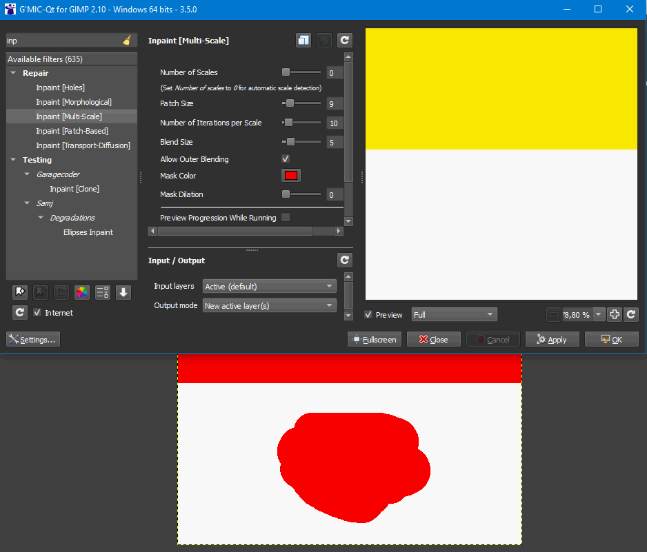

Hi Gimp users
I need help
How do I use GMIQ Inpaint tool to clean an area in a picture?
Thanks
Doron

Paint content you want with GIMP's pencil tool as color "#ff0000" then run the GMIC inpaint filters

Thanks you
I did it and it is working fine

I don't know why the theory is widespread that it has to be red. :roll:
See a simple extreme example:
remove the black circle from the image
when you use red
when you use a color that doesn't exist in the image:
One condition must be met:
the color of the painted area must match (be identical) the one selected in G'MIC!
You can simply specify it using "Pick screen Color" and you will get the desired effect.
result
And work on a copy of the image because Inpaint G'MIC is destructive according to some (they don't use Edit ➤ Undo or Ctrl+z shortcut). :mrgreen:
