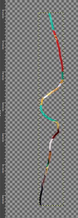

Hi to all.
Maybe I didn't formulate the title of my question correctly, but here's what I'm trying to do: There is curved line in layer, that layer has transparency. I want to move all pixels from this line hoziontally or vertically, so that line become straight. Something like this:
Is there way to do this?

Tas_mania - Thank you for the fast response.
But if the curved line looks like the example below is there way to acheive what in the first post is shown?

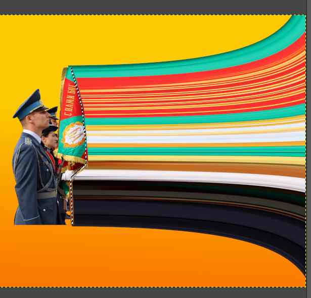

Maybe I should have started by explaining the final goal. By making a vertical straight line containing part of the image and then stretching that line left or right, I want to get the example shown below.
In the example shown, this effect was created by making straight vertikal line copy of image and it looks good.
But it doesn't work so well with other images. For this reason, it is better when I make a copy of the end, (the edge) of the image. Thus, the stretch of the copy will look much better together with the image.
I will try with Tas_mania's 'The snake' solution and share the results as soon as I can.
Thank you, guys :)
