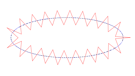

If you have a path (in blue, below), you can use my path-waves script to make a triangular wave around it (red):

That's most of the hard stuff. Thanks.
If I could modulate the asymmetry with randomness that would be close to really nice. Modulate the asymmetry AND frequency, either from noise or more waveforms, or color values - hog heaven. But that's my modular synth background - EVERY reasonable plugin parameter should be able to be modulated, and there should be a reasonable selection of modulation sources - bitmap values, phase and distance or proportion around a center point, height, width, random sources...
Looks like I'll go and see if I can wrestle the python. The pseudocode is straightforward enough...
The other option, I suppose, is to start with that then attack it with other editing tools.

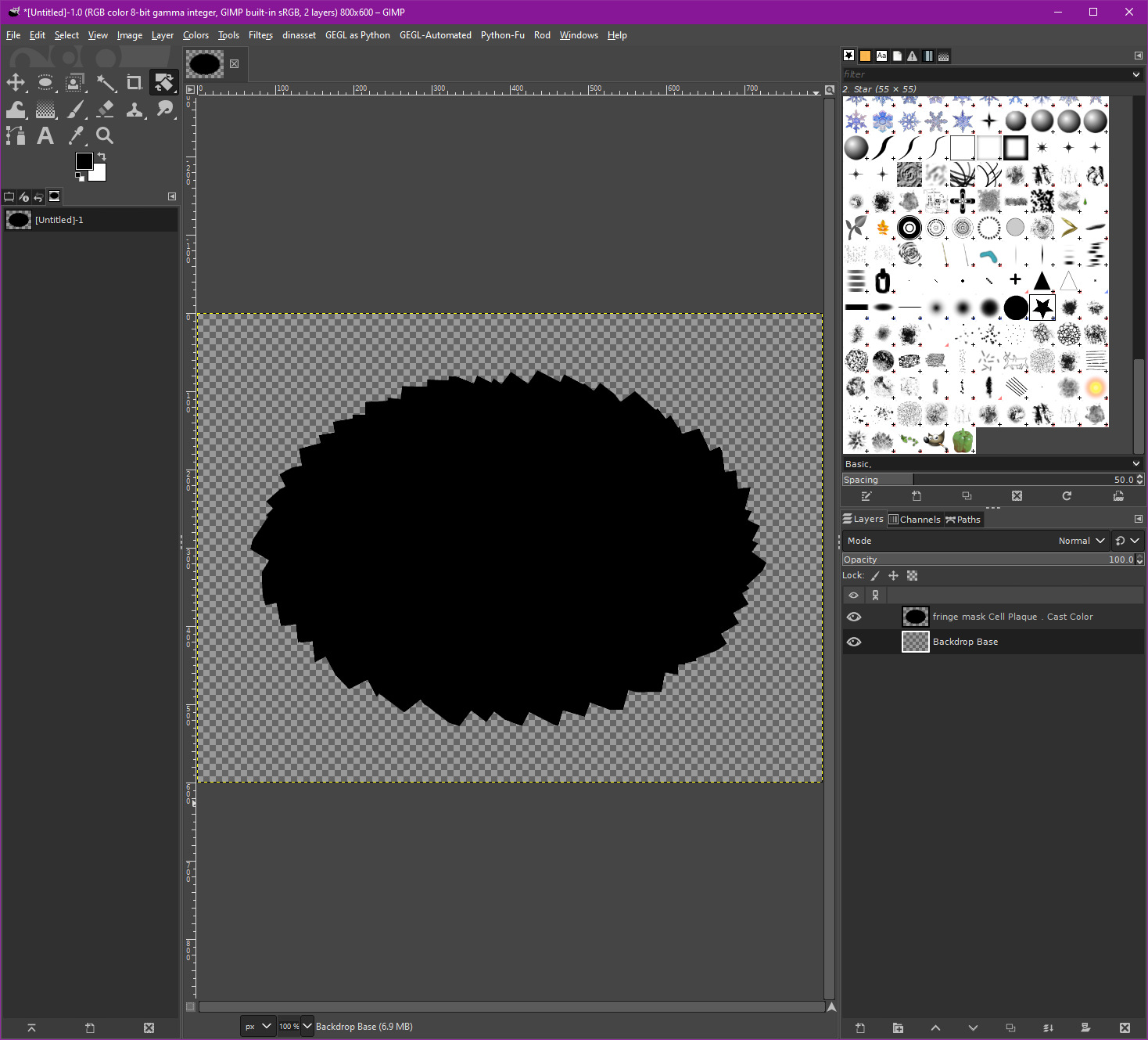

After some Roller experimentation, I was able to make an icy-jag edge with on an ellipse using a Plaque/Mask/Fringe.
File comment: The GIMP window shows the brush used in the included fringe-mask preset.
File comment: Released today. The file has an included 'fringe-mask' preset.
Roller 6.13.zip [4.72 MiB]
Downloaded 85 times

That's a different approach. I'll mess with that. So far I've been baffled by the plethora of brushes, and just use the same three or four.
