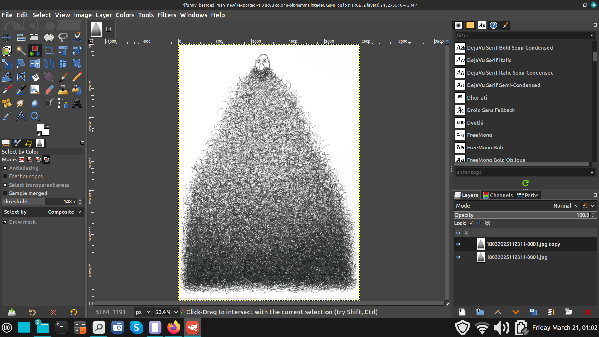

here is the screenshot
 Post subject: Re: separating background from line art
PostPosted: Thu Mar 20, 2025 7:27 pm  (#14)
As you can see in my first answer, the procedure works , I tried it on your image. My PC is a bit more powerful than yours (i7), but that just makes it a bit faster. It's not a make-or-break situation.
I wanted to see the options for the bucket-fill, not the selection tool (which is not used in the procedure).

Haven't used TIF in a long time and didn't recall it being able to save alpha information. Best to save in PNG format; more universally accepted, imo. As for removing the white background, ofnuts explained it well. Can also try color to color to alpha (defaults to white for erasure). :)
I just tried color>color to alpha
the drawing after being saved is coming out a white drawing on black. maybe good for a christmas card. But thanks for the suggestion anyway. I just attached it here, but it is barely visible. I was playing around with opacity and transparency settings.
