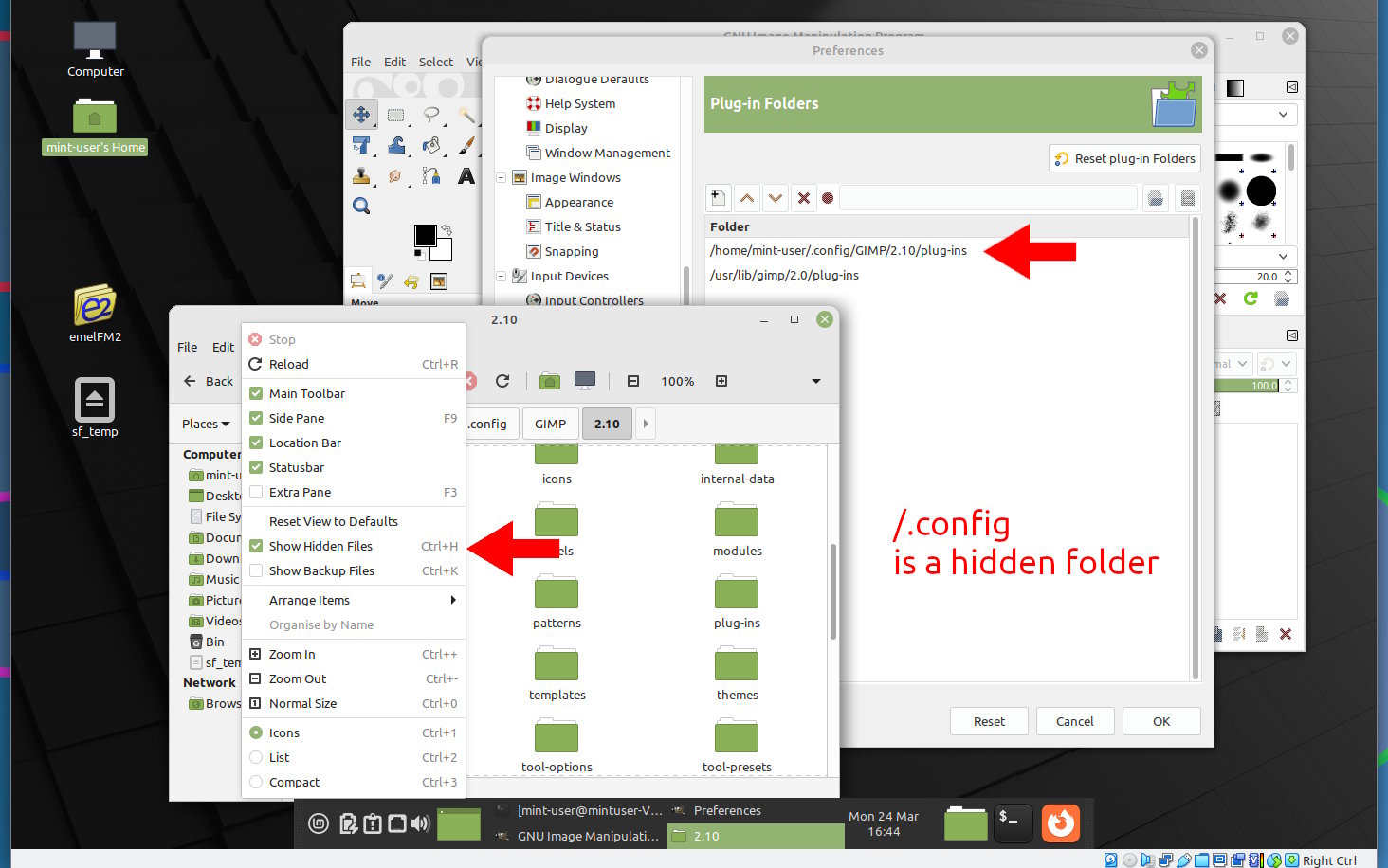

The same as in Windows, you can find the location from Edit -> Preferences -> Folders
A standard installation and your Gimp 2.10 profile is /home/your-name/.config/GIMP/2.10/
The dot-name as in .config means it is a "hidden" file or folder. In the Mint file manager enable View -> Show Hidden Files (shortcut CTRL-H)

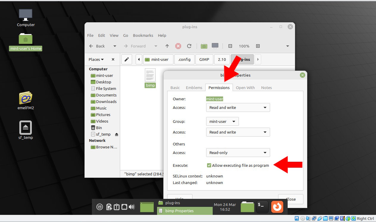

One thing that is different in linux, plugins are "executable" Not difficult, you can do this using the Mint file manager.
