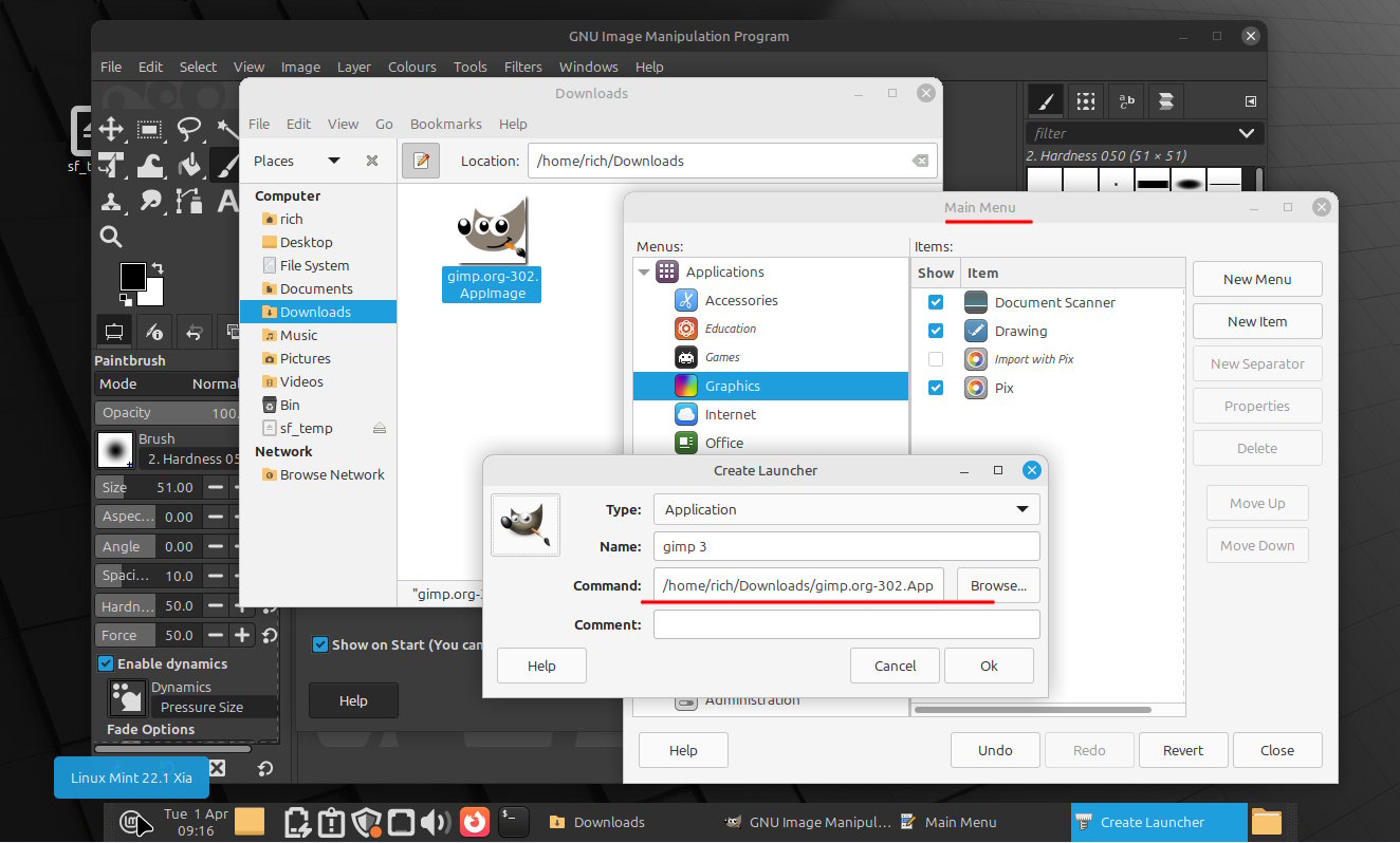

@level_0
You can try this one, https://www.gimp-forum.net/Thread-Gimp3 ... 8#pid43608 - If it works, great. If not then delete it .
You can put it in any folder, make sure it is executable and as an initial check run it in a terminal
./gimp_302_deb.AppImage
If that works then try and make a menu entry using the Mint tool Main Menu. - I know, not easy for a new linux user ;)
edit: Just as a hint for a new launcher in Mint 22
