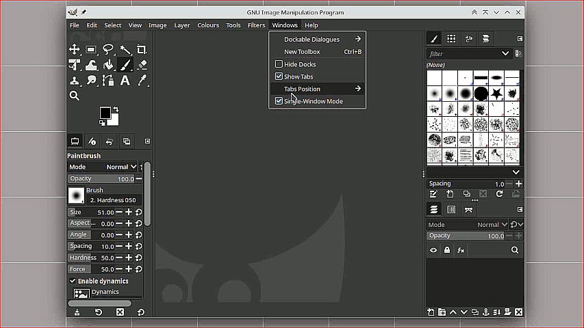

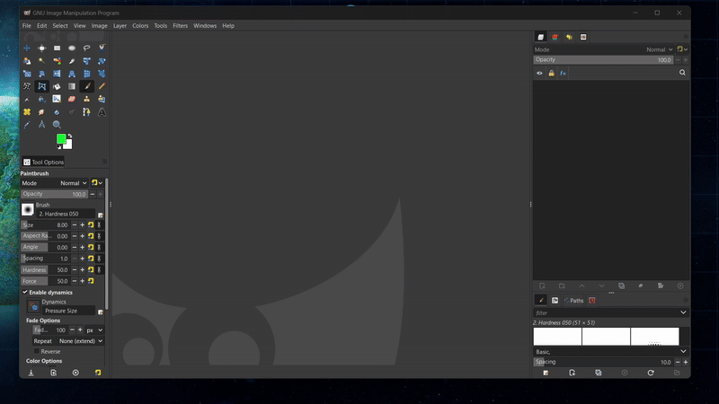

In GIMP 3 the visual cues blue lines
when docking seem less obvious than in older versions,
so you might be releasing the dock too early.
I'm able to move the tool options to the left in GIMP 3.
By simply unlocking the tool options dock and dragging it over to the left.
Making sure to use the blue lines "visual cue",
that's provided when docking.
These cues indicate where the dialog will snap and anchor itself,
once you release your mouse button.

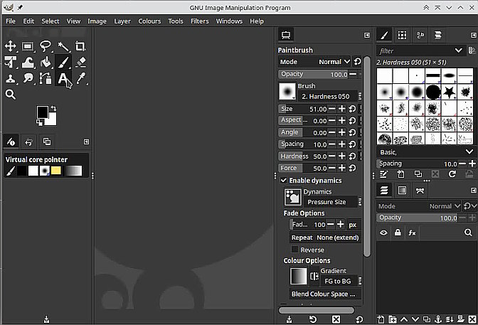

This arrangement is quite popular, especially with 4k display.
Put Gimp into multi-window mode, arrange the docks, then back to single window mode.
