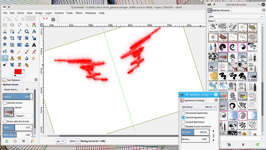

@Gingle
It is worth trying out Gimp 2.9.5 It is quite usable these days and some nice features. I can not pretend to using the 'artistic' tools but they are there.
Shift-middle-mouse button to rotate the canvas.
Symmetry painting
Mypaint brushes.
Depends on your linux how easy it is to install. Ubuntu and derivatives, there is a ppa. There are also 'portable' versions 'appimages' that might work depending on distro.
This is my own appimage in Kubuntu 16.04. Allows me to use a regular Gimp 2.8.20 as well.
