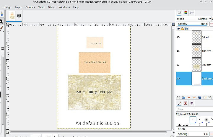

Gimp is a bitmap (raster) editor and works in pixel units. You might have several images ostensibly the same size - say 4" x 6" but with different pixels-per-inch (ppi) values, which means they have different pixel sizes.
If you make a new canvas, especially if using a Gimp template, the USLetter size uses 300 ppi.
Open-as layers is the correct way to go but when the imported images have different ppi then you see the relative size difference. Nothing has changed about your imported images, they are still the same pixel size.
If you want matching sizes then you need to scale the images accordingly.
For example a 4" x 6" @ 72 ppi = 288 x 432 pixels and 4" x 6" @ 300 ppi = 1200 x 1800 pixels
You need to scale the 288x432 up to -> 1200x1800 to fit a 8.5" x 11" @ 300 ppi background

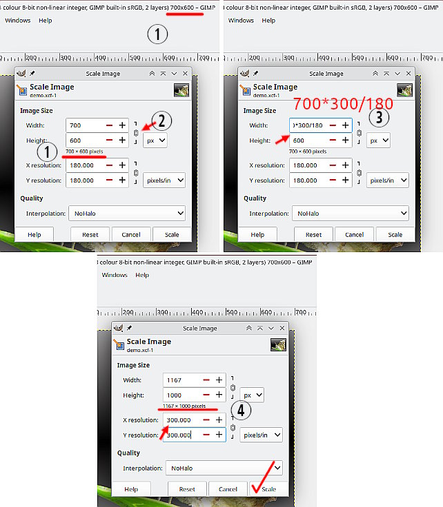

Part 2 ;) It is not very obvious in the Image -> Scale Image dialogue how to get from one ppi to the corresponding background layer ppi.
There is information as to pixel size in Gimp (1) By default values are linked (2) leave it like that
Gimp will do the arithmetic for you (3). Apply the ratio to the width - example is times 300 ppi divided by 180 ppi - *300 /180
Then change the resolution to suit (4) , and do use one of the better interpolation methods.
Confused ;) this a one minute animation of that: https://i.imgur.com/bCOdTpD.mp4
...and checking sizes with Image -> Print Size before and after.
