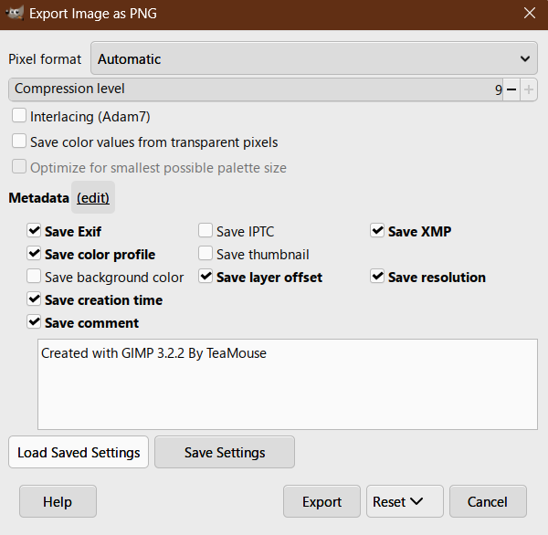

After you open the export As dialog, and then exporting as PNG, after the PNG Export Dialog appears, try unchecking Save Background Color. You still get the warnings but the file maintains it's transparency. It did for me anyways.

Here is a file to see if you are exporting a PNG with transparency in it.

Next select the fuzzy select tool by pressing the U key. Next using the fuzzy select tool, select an
area outside the whale and delete it. Then Press Ctrl + Shift + E, to export as a PNG. Here are
the settings I'm using and I have no problems.
If the image you open isn't using alpha channel, it will not apply one. I just posted 22 new Photo Frames in PNG
with no problems at all, with no error messages. Try following my step with the file posted.

With the shown Export-Dialog from @TeaMouse I got it working:
the "Pixel format" was the problem. I did not touch that in previous tries as I assumed it has to do with color depth and let it in the default state "8 bpc RGB" which should be good to get a small file-size for the icon I worked with. Now I changed that to "Automatic" as seen in the Export-Dialog from TeaMouse. And -hooray!- it's working! :tyspin
