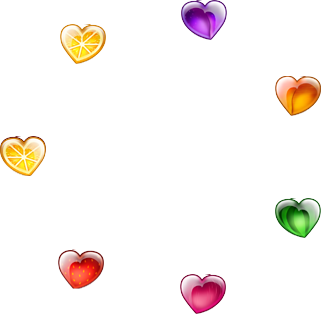

Meanwhile, I made an octagon, zoomed in and placed path nodes on the angle apices and closed the path with Ctrl + Click on the first node. The hearts in the image is a brush I had made from icons. I made 8 layers that were 50x50, put a heart on each layer, centered each one and used that for my stack.
Made a 500x500 image, and made that my gap_000001.xcf file. Duplicated it 7 times so I'd have 8 layers. Used the heart layers in Move Path. Frames to Image and then merged all the resulting frames. Got this.

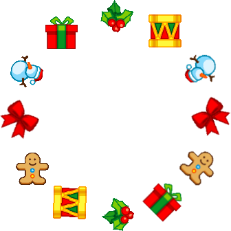

Not having good luck here. I made a 12-sided polygon with the script and it is perfect. I can't get my 12 layers of different images to show, a different one at each point.
Here is the To Path dialog. I have chosen the bottom layer of the source image as I did with the hearts. I can't see anything that I missed in there. Have redone it about 5 times and closed gimp between some of those times to make sure it wasn't holding onto something. I can't figure out what is different from doing the octagon except that I manually placed the points.
I tried manually putting in the 12 points using the other polygon script (Script-Fu > Draw > Polygon) and that still didn't work.
Attaching my 12-layered xmas pix file in case someone else wants to try it and not have to track down 12 pictures.

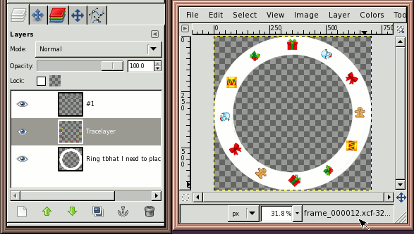

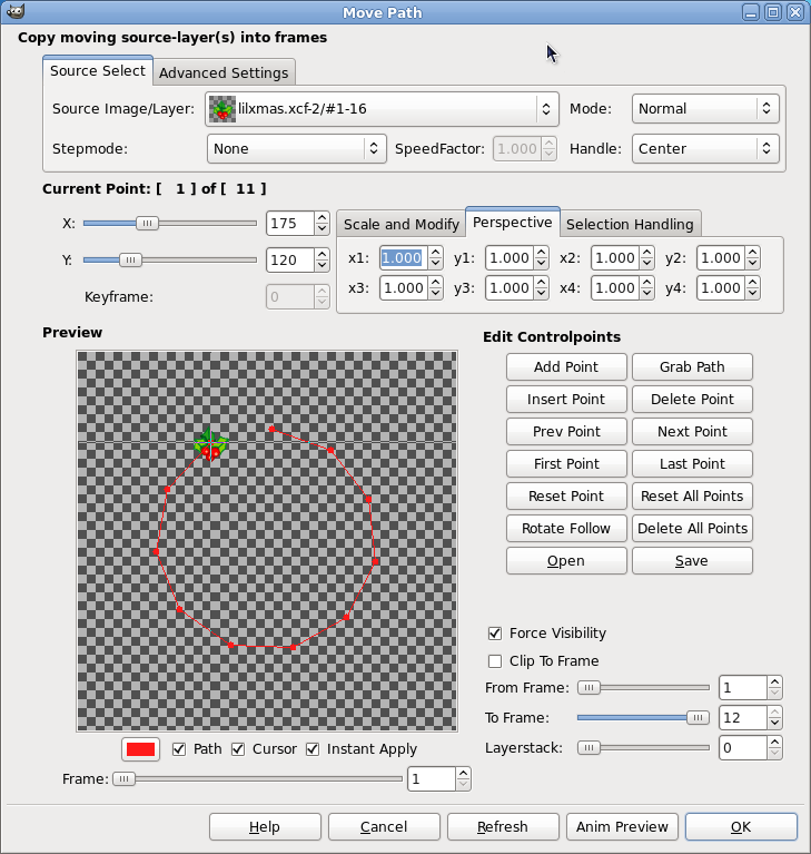

Another option would be to activate "trace layers" in Move Path's Advanced Settings tab. Make both trace opacities 100% and then do everything else the same as you did before.
After the Move Path has completed, go to the last frame and delete the layer above the one named "tracelayer". The last frame will contain all of your objects and there is no need to convert your frames to an image. This approach might be particularly useful for a large image with many frames as it requires far less memory.

OK, that works except that I'm not getting all of the images from the source image. It is an xcf file in layers with 12 layers and each layer is a different image.
I only get the bottom layer which is the one I start out with (#1). What am I missing that I'm not getting all of the layers from the source image to be in the final picture?
You appear to be using a Stepmode of "None"; instead you should use a Stepmode of "Loop".
File comment: Final frame screenshot

Ah! I must have accidentally left Loop the choice on the hearts one.
You have rescued me from running down the street crazily screaming. Thank you saulgoode!
Thank you for the tip about trace layers also.

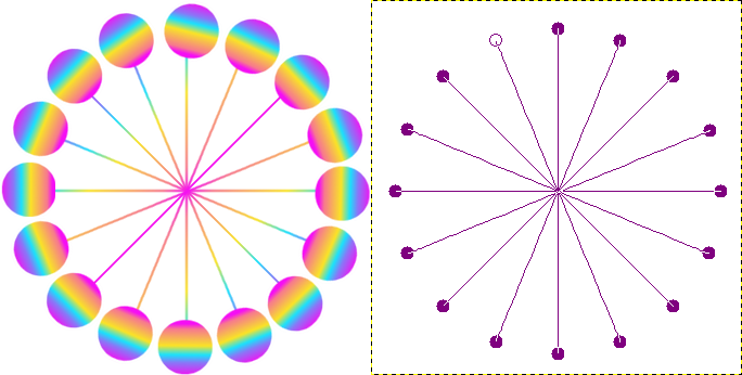

You can have "spokes" going to the objects. These spokes were done by Shift + Click to the lines of the path between the nodes, then joining the nodes the other way. The spokes can be shorter too. Make a polygon with the same amount of sides but with a smaller radius. Do the spokes the same way.
Stroke the spokes with the paintbrush, then lock the transparency and color how you want.
The objects were made to turn with the path by selecting Rotate Follow after grabbing the path.
