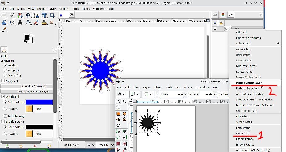

Just a note, if you have Inkscape installed, very easy to copy a path and paste straight into Gimp paths dock. Then you can use the Gimp 3 vector layers function (if you want)
