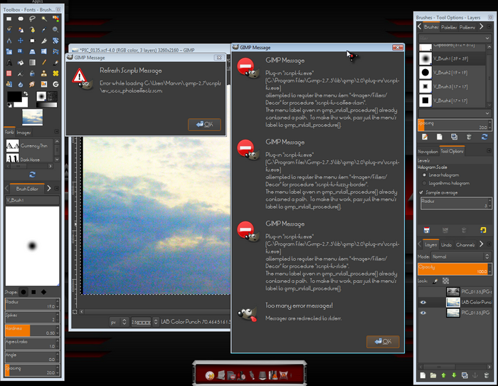

when I load scriptfu I get this crap, what going on?

Likely that you have duplicate scripts... check you script directories in Edit/Preferences, and check that you haven't got the same scripts in the general Gimp install (c:\Program files\...) and in your Gimp profile.

Could you show a screenshot of just one or two error messages at actual size*? I am unable to read what is being reported.
* For example, a full-size capture of the following region:

It would help immensely if you posted a screen shot with legible messages. The writing on the one you posted is too small to read accurately.

From what i may read the message is always the same
"plugin script fu exe
Attempt to register the menu item (Filters/... /....) for the procedure (script name)
The menu label contained in gimp_install_procedure already contain a path...
To make it work pass ???? ?? to gimp_install_procedure"
The first part is very clear the last line about how fix less (but i could not figure out a couple of words )

With a bit of squinting I can just about read the error message. :shock:
It's complaining that the scripts have specified where to install themselves in the menus twice.
This can happen when a script has been edited incorrectly to change it's menu location
How it should be:
(script-fu-register "script-fu-coffee-stain"
  _"_Coffee Stain..."
  _"Add realistic looking coffee stains to the image"
  "Chris Gutteridge"
  "1998, Chris Gutteridge / ECS dept, University of Southampton, England."
  "25th April 1998"
  "RGB*"
  SF-IMAGE       "The image"   0
  SF-DRAWABLE    "The layer"   0
  SF-ADJUSTMENT _"Stains"      '(3 1 10 1 1 0 0)
  SF-TOGGLE     _"Darken only" TRUE
(script-fu-menu-register "script-fu-coffee-stain" "<Image>/Filters/Decor")
If the line _"_Coffee Stain..." has got the menu path in it as well: (which was the old way of doing things)
  _"<Image>/Filters/Decor/_Coffee Stain..."
  "Chris Gutteridge"
  "25th April 1998"
  "RGB*"
Then you can't have the line
Because you're trying to locate it twice, and get the error message:
Plug-in "script-fu.exe"
(C:\Program Files\GIMP-2.0\lib\gimp\2.0\plug-ins\script-fu.exe)
attempted to register the menu item "<Image>/Filters/Decor" for procedure "script-fu-coffee-stain".
The menu label given in gimp_install_procedure() already contained a path.  To make this work, pass just the menu's label to gimp_install_procedure().
Where it's probably going wrong for you is that if you have two versions of the script, that use both methods to locate itself, then you get the same error message.
