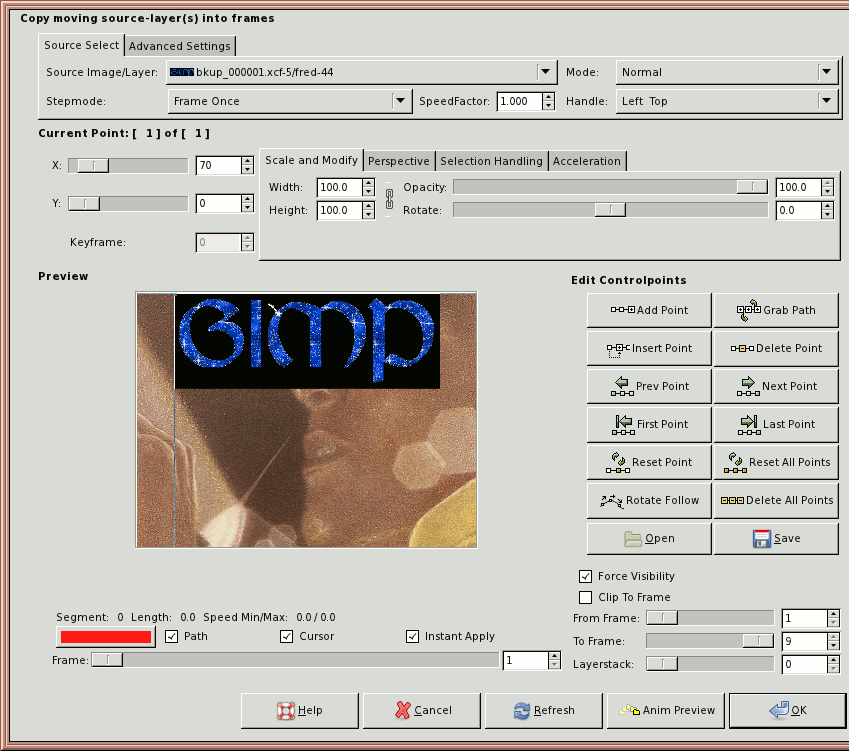

PostPosted: Thu Sep 22, 2011 8:04 pm  (#7)
Joined: Apr 23, 2010
Posts: 1553
"Video->Move Path" (it is best to calculate the X offset beforehand; i.e., one-half the difference in the widths).
 Post subject: Re: Gap -combine frames Help
PostPosted: Thu Sep 22, 2011 8:14 pm  (#8)
Saulgoode you my hero!
i was sure the solution was in move path but looks so complex..
i didn't notice the "instant appy box " unchecked so what i saw was very discoraging,
more i experimented with wrong step modes
thank you
a thank to you Rod too the 2 scripts may came handy , ..well now i prefer praticing doing with GAP, but the extend all layers to image size may be a timesaver for other works

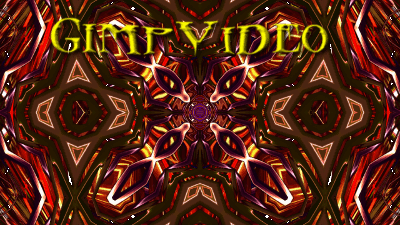

PostPosted: Thu Sep 22, 2011 8:52 pm  (#10)
Now I have a new splash!! :jumpclap
And i will do a better one tomorrow !!
THANK YOU !! :hi5
