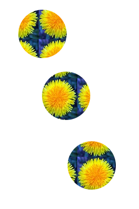

You should make your images 1.403"
Trying to make your paper size different so they will print correctly would be way too hard.
I made a grid of 1.403" and sized the ellipse tool to one of the grid squares.
The ellipse tool set at 101px works out to your image size if that is what you are using to make your circles.

Here is an experimental image I made using 1.403 for the ellipse size and image size of 4" x 6", and using a layer mask. You can try printing this image and see if the measurements come out how you want them.
