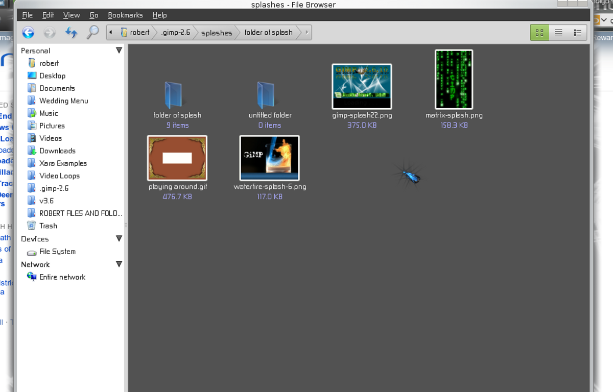

The image names do not matter as long as they are in the /splashes folder. Or so my experience has been.

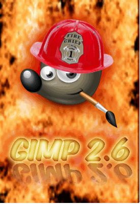

I made an attemp at a gif splash but I'm not satisfied with the flames.
