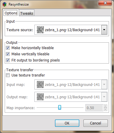

That's the problem making seamless texture Drac. I've learned many tricks over the years and in fact, seamless textures is sort of a side hobby to my retouching hobby. Anyway, a cool feature of Resynthesizer is it's ability to make seamless textures on the edges. What you do is select all, shrink 5 to 10 px (or more if you have a large image) then invert select. Now run Resynthesizer making both vertical and horizontal seamless option enabled. You may have to do some cleaning afterwards. First do and x/2, y/2 offset and then clean away (I did for your sample; not much needed). :)

Lyle, where can I get my hands on Resynthawhosywhatsit? Knowing your MO, I have to assume it's a separate filter.
PC. Thanks for the idea about using mirroring. I didn't think about using it for this application because I'm looking to fill a larger area and make it look continuous like a large skin rather than a repeating pattern. Gave me a couple of ideas for other things though.
