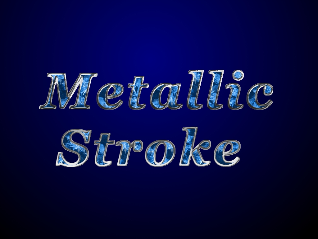

Is this what you are trying to do? If I understood you correctly you want a metallic looking border.
The second one is just the border by itself with a 3D effect added.

Bingo! I have the picture of it in my head .. I just don't know how to get to the finish point. Probably why I'm sure sucky artist. :(
Draconian :yes that's it! I'm such a noob.

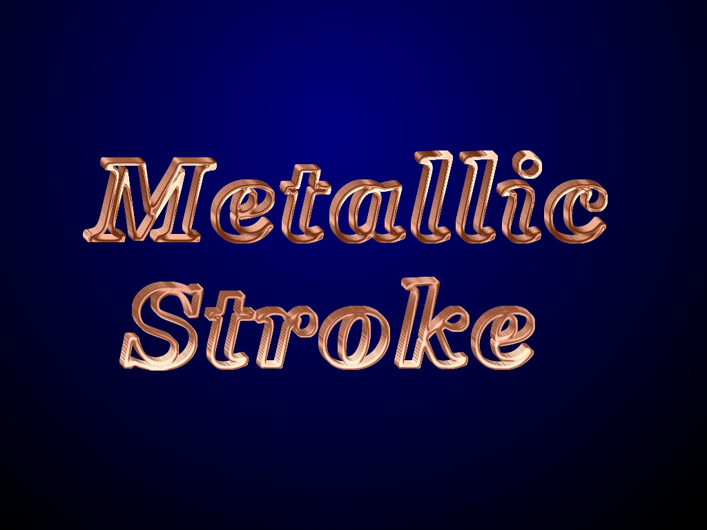

Now that we know prexactly what it is you are trying to do it makes it a tad easier. The reason you are getting the greyish-white mess may be that you are trying to do it with a "stroke" operation. Metallic effect requires a certain amount of "landscape" or depth to the image or text. You can find several tutorials here that explain different ways to do this. One of the simplest ways is to have a blured layer to use as a "map" to create a 3D look. If you take some grey text on a black background and then go to Colors>Curves you will notice there is no "structure" for the curves to work on so the only thing you can do is lighten or darken the image. Here's what I did to get the metal outline.
1. Make some grey text on a black background, center it using the alignment tool. (don't forget to right click on the text layer and go to Layer to Image size. This step is very important as some operations won't work until you do this)
2. Duplicate the text layer and on the top layer Alpha to Selection, Select>Grow 3 pixels and drag the grey color over to the selection to "fill" it. Then Select>None. Name the first layer "text" and the second one "border"
3. Right click the "text" layer, Alpha to Selection then go to Select >Shrink and set to 3 to 5 pixels. Now while that selection is active on the "text" layer click on the top "border" layer and hit delete. Turn off the text layer (click the little eye) to see the "cut out" border you made.
4. Duplicate the top border layer and name it "blur". On the blur layer go to Filter>Blur>Gaussian Blur about set it to about 5 or 6 then turn off the layer
5. Go back to the border layer and go to Filters>Map>Bump Map and make the Depth about 5, hit OK.
6. Right click on the same "border" layer, Alpha to Selection, then go to Filters>GMIC>Tom Keil's Filters and pick your color.
I hope I made this clear enough.

I use Ofnut's Neon Decorate plug-in to get that single stroke text look. Not much different from Draconian's approach, only I use the path layers from Neon to emboss and bump my text.
That really looks great Mahvin! I've never bothered to investigate how to use paths. If you wouldn't mind stepping us thru it, we could all benefit. Just a "flow",as Lyle would put it, would be sufficient as long as we know which layer you're doing what to. BTW, I couldn't that plug-in listed at the registry or anything "neon" for that matter.
Thanks Lyle. I probably could have used a wider border so you could see the effect better.
