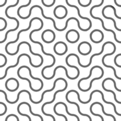

No need for a script... you create a Gimp Image Hose with two images like this (white background optional):
save it as a brush (with a 100% spacing), and then apply regularly (using grid/guide or preset path):
There could be a slightly simpler way if one can apply a pattern at random (then you would just bucket-fill...) or if there is a script somewhere to create transparent squares at random in a layer (you would then create a layer with each pattern, and punch random holes in the top one).
Back in the 80s, a colleague of mine used this very pattern to try to spot regular patterns in long bit strings (0 makes one pattern, 1 the other), he said non-random bit patterns translated to visual patterns rather easy to spot.

Well, ofnuts, I've done everything I can think of doing to that brush you posted.
I can't make anything that looks like what you made. Brushes made from it are just disjointed quarter circles. I tried copying it as a pattern and still no joy. What am I supposed to do with that image you posted?

ditto from above,
there is a large space between each them and I can't figure out how to place them.

I "flattened" the brush to show the two images it contains, but its really two 40x40 layers, one with the arcs around the NW and SE corners and the other with the arcs around the NE and SW corners.

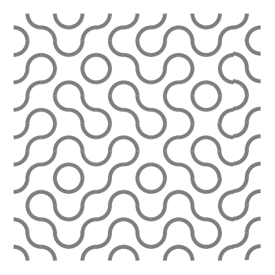

Very cool ofnuts. Used RobA's Mosaic Helper (concentric squares set to 40 radius) and then stroked the path to attain the pattern. I then strategically cropped to create this seamless texture. :)

I also updated your seamless pattern to remove the 4 way circle connections and tossed it into the Mirror array to expand it. See attached below:

edit: looks good Mahvin; I agree, that my original could have used some cleanup work. lol
