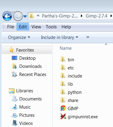

I have been trying to install your Gimp 2.7.4 for a couple of weeks now. It will install okay but I have to click 14 times before it opens. The error says entry point libgimp 2.0-0dll could not be found. I went to the Bin folder and it is in there.
Also, there is no gimp.exe in there except the one in the bin folder. It says in your web page not to open it from there. this is a scrn shot below to what is in the folder.
Anyway, I did try to open it from there when I couldn't find it and this is where I get the 14 errors.

Did you download the "standard" version? If you did, you simply click on the exe file (it's an installer which sets everything up for you). If you download the portable version, it will also set it up for you (without affecting your path etc.) and then you click on gimprun.exe to run gimp.
Feel free to send me an email and I will walk you through it. :)

I don't see a gimprun.exe anywhere, that is what I was looking for. I installed the regular version 32-bit. I have just what you see in the screen shot.
Your screenshot looks fine. that is how the the folder should look.
gimprun.exe is for the portable version, so you can ignore that comment.
