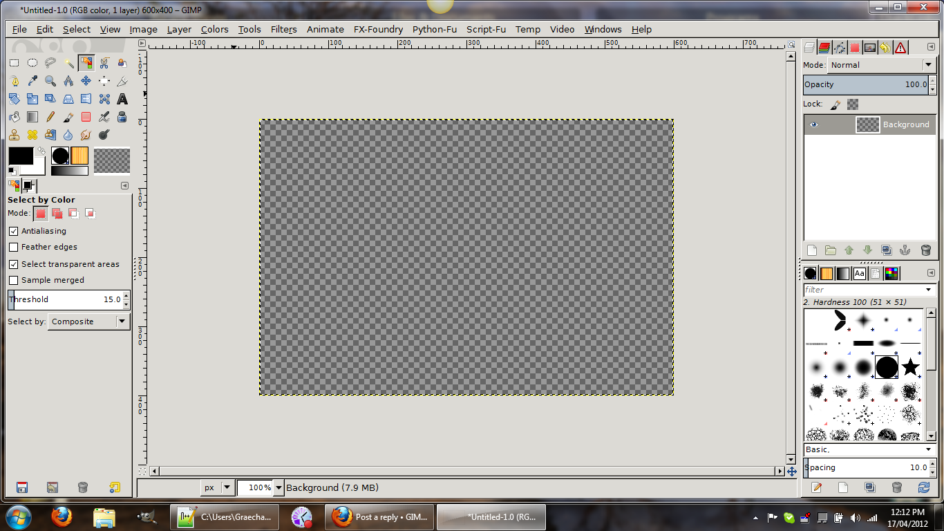

Problems using wrapmap with gimp versions above 2.6, first of I am using a windows enviroment, and the image I am using is shown below in 2.8rc1 with the selection in red
All I get back is a error 'no selection found'

The image I am having trouble with is a transparent layer with a black 1px border
Here the actual layer is shown with the border selected prior to running 'wrapmap'
This is the layer ued in the picture frame script

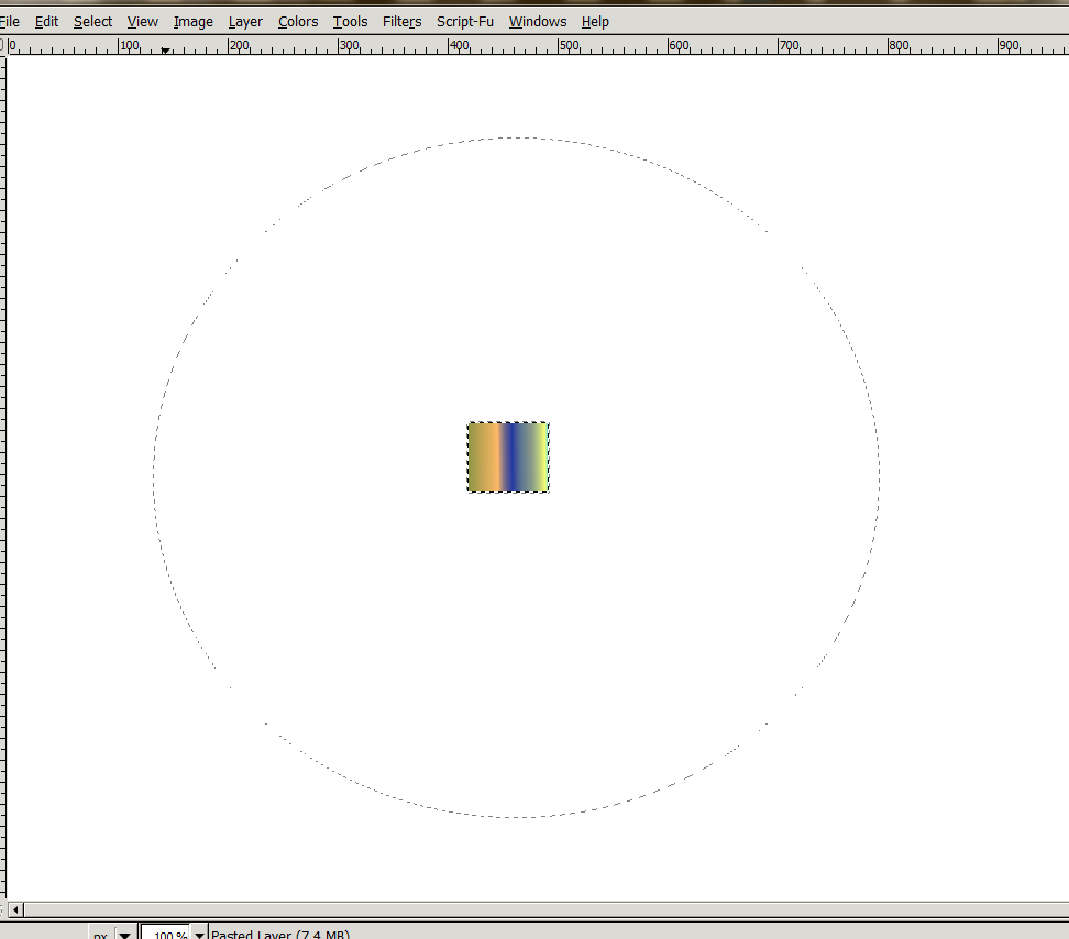

If you don't choose the small gradient sample target you get this behavior Rod; trust me, that it happened more then a few times to me. lol

You can either choose a bounded layer (i.e. object smaller then your overall image dimensions) or just create a second (and smaller) target image; you can select either. Note the bounded gradient Rod and then the circular selection which is required. The bounded gradient in this case is on a separate layer. Again, you can just as well have another image as source too. :)
