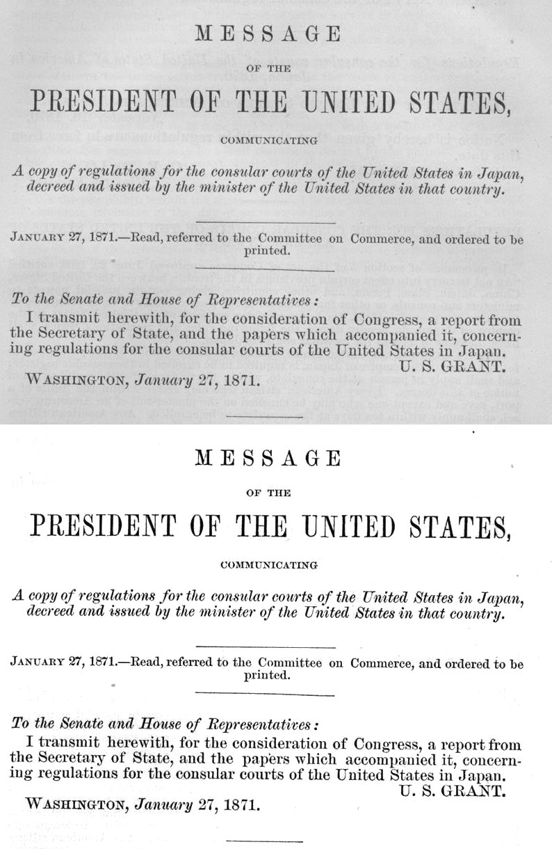

This script is another Gem of a script from Leon.
Before
After

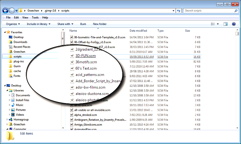

We have a few topics stickyed on how to install resources into Gimp that may help you.
You can find them here -
viewtopic.php?f=8&t=721 - MAC
viewtopic.php?f=8&t=720 - LINUX
viewtopic.php?f=8&t=719 - WINDOWS
Those 3 posts cover how to install scripts into Gimp on all platforms.

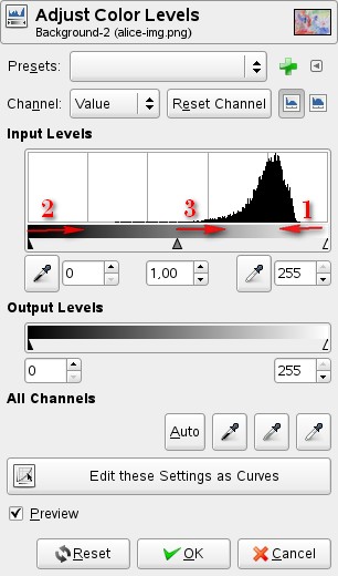

You may just be able to use the levels tool - that is comparable to what most scanners will use to clean up images automatically:
http://docs.gimp.org/en/gimp-tool-levels.html
use Colours->Levels, and in the dialog pull down the white input level (1) until the background is white, pull up the black level (2) until the text is black, then pull up the gamma adjustment (3) to get the best contrast with out the text getting all aliases (jaggies):
