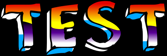

Oh I thought you were talking about the text. The background is the easiest part. I did a quickie in about 20 minutes to start on the text so you could see. You will have to make a new transparent layer and actually draw the corner edges of the bevel with the pencil tool. Zoom in on the pic and you'll see what I mean. I set the bevel script "mode" to soft light to lighten it up a bit then I did an "alpha to selection" on the bevel layer, made a new white layer and adjusted the opacity to what I liked. By doing the alpha to selection step you "limit" the affected area to within the confines of the selection for what ever operation you are using at the moment. You can delete areas outside of the selection by going to Select>Invert>Delete. When I was making the shadows and highlights, I always do stuff like that on separate layers so if I mess up I can either undo or delete the layer entirely without affecting the other work.
Here's the script for the selection bevel. Tell me exactly what you are trying to do with the background. I would suggest doing each section on a different layer to give you more control over each operation like I did with the two colored layers, then merge them together when you are sure you're finished working on them. You can also duplicate them both, turn off those duped layers and that way be able to go back and start over if you need to. (I guess you can tell I screw up a lot) LOL
bevel2_1.zip [5.91 KiB]
Downloaded 114 times

I did the colors inside on 4 different layers.

Scroll down in your quote to see my responses. Here's my xcf file so you can see some of the layers after I merged some of them
sample text.xcf [188.38 KiB]

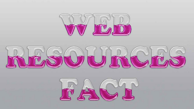

If you really want to get fancy, there is a PS tut for liquid filled text that is much better looking than a similar one I've seen done for gimp. Here's the url and a sample pic.
http://www.webresourcesfact.com/2011/03 ... oshop.html
