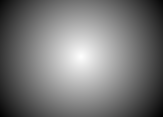

You could always create a radial gradient layer mask this one shown. :)

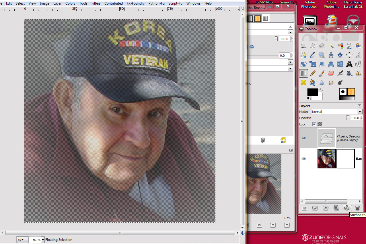

The magic of layer masks. You can also click on the layer mask and paint white or black depending one what you what to show or not (or shades of gray to add some transparency or make something semi-solid). Note the anchor message; you have to click the anchor button to paste your mask into the layer mask part of the layer. :)
