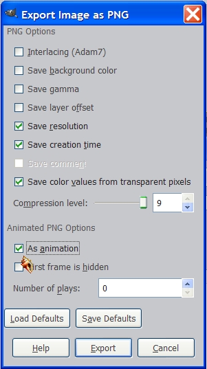

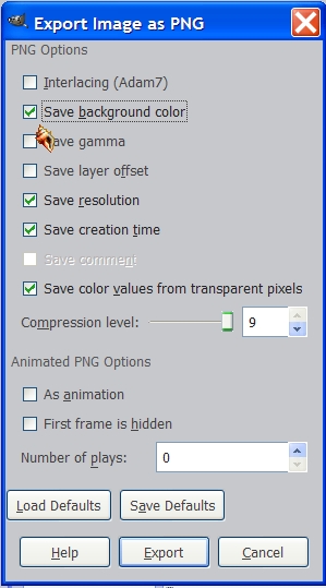

By default, saving as a gif with a transparent background will act like saving as a jpeg and it will automatically put a white background behind it. To save an animation with a transparent background, it has to be saved as an animated png or .apng. There are several threads here related to installing APNG so you can do this very thing.
I cleaned up your gif a little and got rid of some of the white backgrounds in all of your images as best I could (in a hurry), recentered some and cropped them all. I then sved it as a png. When the dialog comes up make sure to uncheck the save background box and check the save as animation box. Go to filters>annimation>playback and you will see your transparent background.
