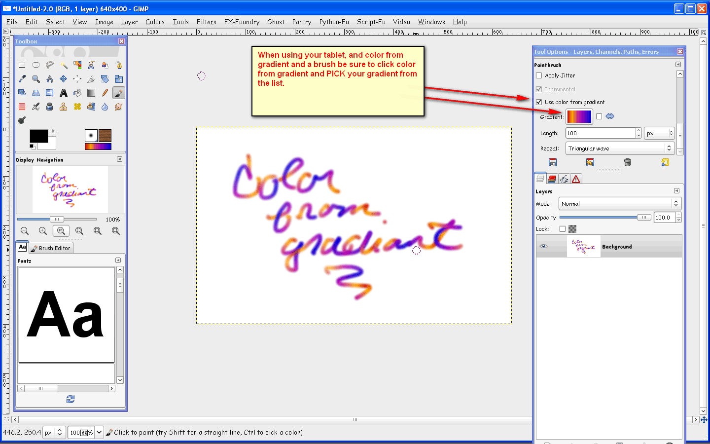

This is an example from my Hanvon tablet.Gimp-2.6.11
Using pressure

Well seems I had to set the pressure curve.
It is now at 94 6 94 6.
And it's working in 2.6.11.

This is from my 2nd partition.
You have to set brush dynamics to Random Color.
Tried to edit and set it to "Opacity" but that didn't work.
I set the tablet pressure curve the same as in 2.6.11.
Let's hope this wil get ironed out in 2.8.
I need 2.7 for it's ability to rotate brushes.
Thanks again Rod.
