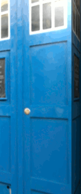

And the proof...
It's not quite how I wanted it. I've got to play with map object a bit to get to grips with it.

PostPosted: Fri Jun 01, 2012 4:05 am  (#12)
Posts: 16293
Dr Who? :)
That's neat.

Still not quite right but getting better.

You seem to have a rouge frame in there.Looks like frame 1 is sinking in a little.
Or was it meant to look that way?
 Post subject: Re: GAP animation - map object problem [SOLVED]
PostPosted: Fri Jun 01, 2012 5:51 pm  (#16)
I noticed that. I don't know how it happened because I let GAP do everything. When I've done a successful one, if that is still there I'll probably just delete the frame.
