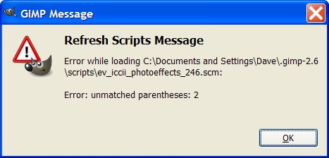

See screenshot
I keep getting this error message for this script everytime I try to refresh my scripts. Is the dern thing corrupt now or what?
Secondly, what does "unmatched parentheses: 2" mean?
I'm getting two other errors on two other scripts but let's just address one at a time for now.
Means what literally say : script fu uses a lot of parenthesis and each opening parentheses should be matched by a closing one
Almost always the error came by copy and paste ..so download again the script should fix
That the easier way to fix but if you have a text editor with syntax highlight supporting scheme (doesn't need to support script fu, scheme is sufficient ,maybe even Lisp ) it should highlight the errors
Or you may feel lucky and just try :usually the misses parentheses are at the very end, so adding 2 at the end may even fix

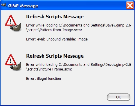

I started from scratch with everything except my user folder. I may have something left over from the mistake I made way back when I downloaded 2.7 insstead of 2.6. Maybe some left over dll files but I don't know which ones to delete.
I'll try a dedicated MM folder next and see if that helps.
On another note.....I downloaded fresh copies of the three scripts that were throwing errors and reinstalled them, but it only fixed the first one. Here's what I get with the other two now.
Can you point us to where you got those scripts from please.
Those are very odd messages to get from the Refresh Scripts, which suggests to me that the files have been corrupted somehow.

I started getting feelings of deja-vu - we looked at these same script files when Molly had problems with my test for duplicate scripts:
viewtopic.php?f=9&t=3057&p=54156#p54135
This time there's something odd going on with the version in the thread:
http://www.gimpchat.com/viewtopic.php?f=9&t=3994
as I get the same error after downloading and extracting from the zip file, but Graechan says that the zip should now have a corrected version of the script, although no-one has posted anything about having tried it since it was last updated. ??? (it contains a rel 0.2 version)

Kevin - You are correct, I got the picture frame script from Gimpscripts yesterday and it was the Rel 0.2 version so I'm not sure what to do from here for that one.
I'll try replacing the pattern from image script with the one you suggested and get back to you.
Molly/Kevin - My desktop is 2.6.11 and my wrapmap is 0.3.py
Now what?

Kevin - Just dl the picture frame script from the link you provided and replaced the one I had. Opened Gimp and opened a new image, made a new transparent layer and filled a selection so I have two layers open. When I refreshed scripts, the same "illegal function" error popped up for the picture frame script.
It's not imperitive that I have this script but it's annoying enough to want to learn what may be causing this.
Molly - the wrapmap.py (0.3) is in my user\2.6\plug-ins folder with all the other python filters just like it was before this mess started.
Should I post the code for the picture frame script I have so that maybe some of these code writers or perhaps Graechan can eyeball it?
Yes, and also make sure you haven't got another copy of the file so try temporarily moving the one you think you're using out of your script folder and refreshing and make sure you haven't still got a menu entry.

Yes, that one's fixed but this picture frame thing is still throwing the illegal function error. I thought it might be a conflict between it and the mats and frames script but after I removed it, I still got the same error.
You ready for this......The script works flawlessly! Why the error message only on refreshing scripts?
Because it's got a block of code at the bottom of the file that's invalid, but GIMP is apparently just ignoring it and registering the script anyway. To make the warning go away remove the following from the end of the script file:

Problem Solved! Thanky, Thanky, Thanky. I deleted that block of code as suggested and it no longer throws that error. Just out of curiosity, I would still like to know what it was trying to tell it to do that was "illegal". (Should we call the cops, or just Graechan?)
Now where's the best place to get the 0.4 version of wrapmap.py so I can put it on my Win 7 laptop with 2.8.1?
