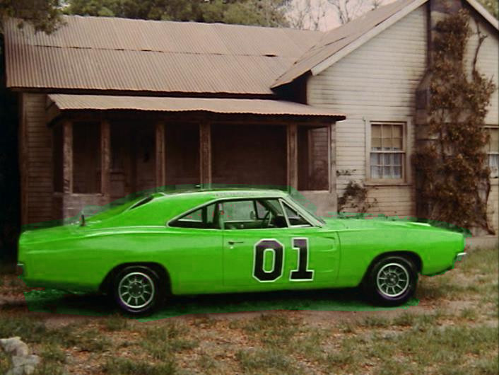

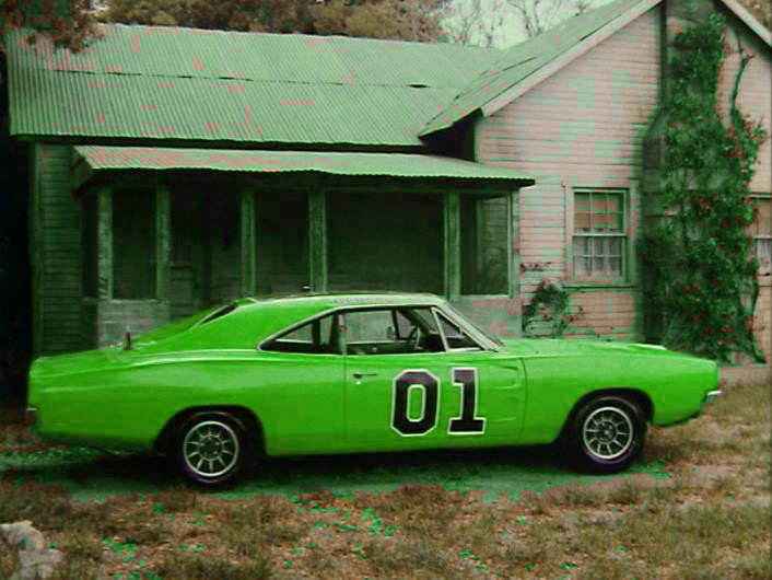

well here is the problem, as i see it
even if you try Alex trick with changing the colors so that the desaturation process is enhanced, there are other portions of the picture that become green
even if you use a rough selection, the green still bleeds into the background
i think this isnt a very good picture to work with in the first place
you could try making a path around the car, use the selection for creating the white in a layermask, and then tweak the layermask manually with the brush
but i think thats still very hard
