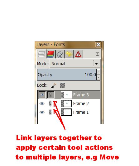

ok i am trying to move a gif file to a certain spot but i cant because then i have to move it by frame by frame.
is there a easier way to move the gif with all the frames at once?

b10h4z4rd wrote:
yea i know i figured that out but it takes forever to do that one by one

Are you aware of CTRL click, SHIFT click and CTRL-SHIFT click?
To toggle the icon? That works with the 'visible' icon too.
omg thanks allot dude that helped allot :)
