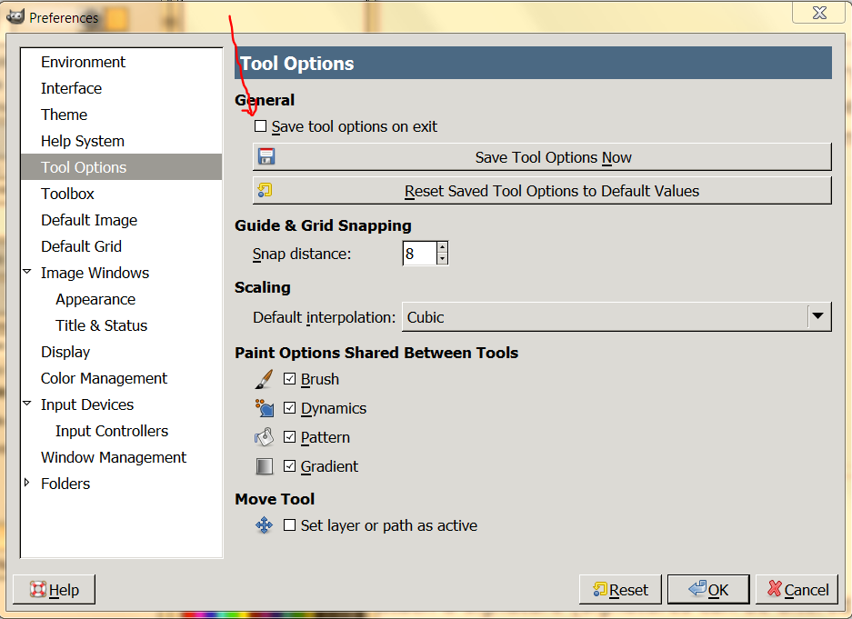

 Post subject: Re: [Solved] User prefs behave strangely
PostPosted: Thu Sep 20, 2012 2:28 pm  (#15)
As default all brush tools (so including eraser, airbrush, dodge-burn convolve ) have shared option,
If you have the option on , the preference of 1 tool will be modified inderectly if changing that of any other brush tool
The first thing i do after installing is enter in preferences/tool to correct that, un-check the box with that option
Because the best brush for the brush tool will seldom be the best also to erase ,, or convolve, or airbrush.
Not sure is this may be relevant for your problem, for sure if you are not aware to have switched on the option to force several tools all to the same default , try to change defaults may give headaches
PostPosted: Thu Sep 20, 2012 2:34 pm  (#16)
PS if my suggestion doesn't solve better open a new topic, because this is labeled as"solved"
