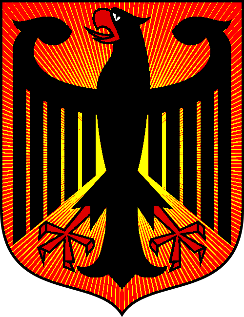

Had a play with your image
Heres the xcf file

pretty cool, he4rty !
even more impressive when you have a look at the xcf
did you use a selection tool or did you render the eagle with a layermask ?
i tried something with filters -> render -> line explosion but didnt like it enough to post

PostPosted: Sun Sep 23, 2012 2:51 am  (#4)
Joined: Aug 30, 2012
Posts: 2174
Basically I just selected the black area of the image and used that in place of the text in the tutorial, selected the black just by using the colour selection tool. then rather than colourising the rays I created a new layer filled with the orange from the orignal image background and set layer mode to colour, finally I isolated the red onto a new layer and moved up so it would show.

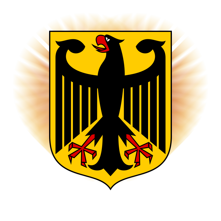

Line nova has a pretty cool effect with just a few tweaks. :)
http://registry.gimp.org/node/26237 (bottom scm file "line-nova_20101016.scm" is the 2.8 version)
Workspace (XCF) file attached.
Coat_of_Arms_of_Germany2_RD.xcf [472.51 KiB]

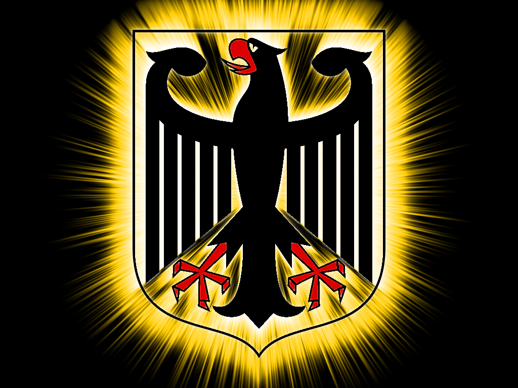

Probably not what you're looking for but I like to play with GIMP ...
<br />
<br />
<img src="http://www.gimpchat.com/files/269_flamed.png" alt="Image" class="resize_me" />
Actually, that pretty darn close! How'd you do that one? I can play with it. Would just need more on the top & bottom! Thx!

The basic idea is to create an image twice the size of your coat of arms, make an elliptical selection of 1300 pixels, fill the selection with a gradient of your choosing, I used incandescent because I seem to be missing German Flag Smooth, the obvious choice. Then I created a template wheel by creating a new layer and using a white brush stroke of 25 pixels at 6.125, 11.25, 22.50, 45.0, and 90.0 degrees. There are countless ways to do that but I find the script-fu copy-rotate script to be simple and effective. It creates something similar to a bicycle spoke. Then, by doing an alpha to selection on the "spoke layer" and inverting the selection it creates a cutout of the Gradient layer. Once cut out it leaves wedges of color that can be gaussian blurred, as I did, or played with using the countless other scripts and plugins. I'm sure someone smarter than I am will have some other ideas. I can't post the xcf file here for you or I would.
