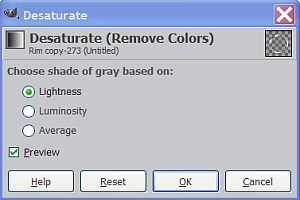

Changing the color of anything can be achieved easily by going to Colors>Desaturate and chosing one of the three options. It is interactive so you can see the results as you select each option. Pick the result you like the best and click OK.
As far as copying the text, is this a real book or an image of a book? You said 5 lines - is this 50 words or 10 words?
