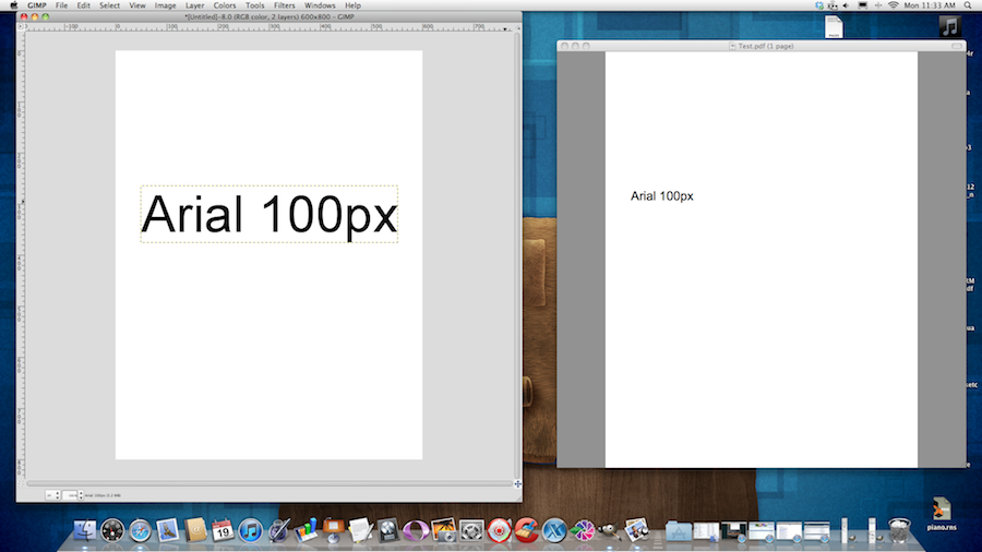

Hello,
I have recently upgraded to Gimp 2.8.3 on my Mac OS Snow Leopard, primarily for the new "export to PDF" feature that would keep text searchable within PDF.
The results are very odd... The text in the exported PDF is, indeed, searchable and copyable, but the font size shrinks drastically (see attached screenshot).
Any ideas on what could be causing this issue and how to solve it? Thank you very much for your help!

It's probably the print resolution setting in Gimp. Go to, Image, Print Size settings and make sure it's 300 +.
Setting print size or creating new file at 300 ppi in GIMP does shrink true type fonts when converting to pdf. Leaving it at 72 dpi doesn't shrink the text but the resolution is low. GIMP isn't the best tool for this. I would recommend Scribus as intermediate backend software for converting to pdf.

Thanks everyone for trying to help, but the issue persists. To clarify, the screenshot I've attached before is just a simple demonstration of the problem... But the actual Gimp document in question contains both images AND text. Images export fine, and text shrinks drastically. "Print to PDF" does the exporting to PDF but loses "copyability" of text (converts it to shape, I suppose). My goal is to preserve the "searchability"/"copyability" of text upon export to PDF.
The print resolution is already at 300 dpi, so that's not it. And I've tried converting pixels to points - no improvement in resulting PDF.
And I've installed Scribus, but now I'm in the dark as far as how to get my image/text document FROM Gimp TO Scribus for exporting to PDF.
Any other suggestions??? Thank you so much for your help!

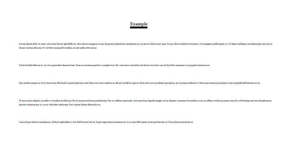

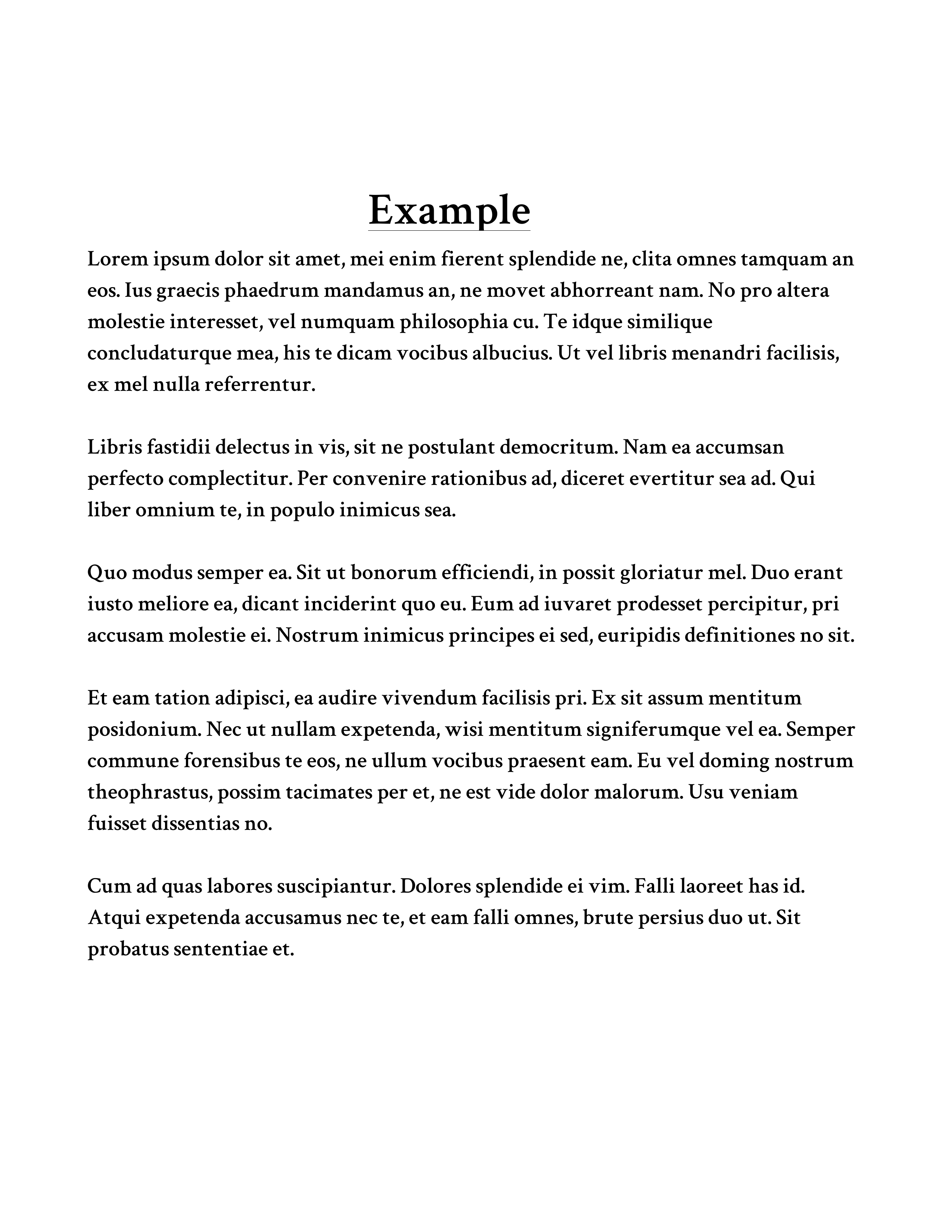

I have the same problem today as well. See below.
File comment: Export to PDF File
The only way to to make it as the same file is what momobear said. Save jpg to PDF by using Gimp or any image software that support export pdf or an online PDF converter.
File comment: Original File
