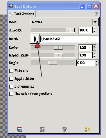

I try again to explain is very simple:
open the brush selector thingy (as example clicking on the icon of the active brush..see image)

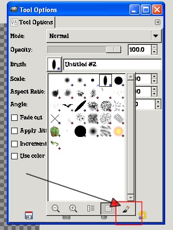

then look to the lower right corner of the new dialog, the brush icon correspond to "create a new brush"
