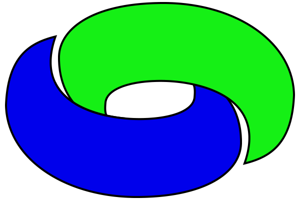

I have created this logo for a newsletter, I'm not satisfied because I would like improve some things, but all tutorials that I have tested are not convincing on my logo.
I find the lines edge of logo too crude, not smooth enough, I have used paths to trace the line edge but it's too pixelized. I don't see how simply smooth them.
My colors are too basic, I have tried to add glossy layers but the result is little strange, it's not what I would to do.
I feel like drawing as a child.
What you do in my place to beautify this logo ?
I am open to any proposals or creations, I leave you available the xcf.

apparantly you didnt use any curves when you drew the path, thats why it looks so crude
i think you would get a better result if you made this logo in Inkscape
or try to construct your logo with a combination of ellipitical selections and the path tool
basically its a big ellipse with some parts cut out
i think the colors are too garish, i would go with a less colorful tone

I can't say I know what you need exactly, here's just a quick shot at it (using your image)
Just made the paths smooth and added gradient because logo looks flat without gradient.

Inkscape version

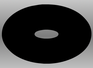

here is my result:
im afraid jamac4k was right, i got pretty jagged edges too, although i converted everything into a path :(
to mask that, i used the dropshadow
used a bumpmap to make it a bit less flat (Gaussian Blur 10, Depth 13, Azimuth: 295, Angle 39)
and a bit of lighting effects (Intensity: 0,3/Glowing: 1/Bright: 0,1/Shiny: 0,7/Polished: 10)
i got the logo by setting guides and subtracting two elliptical selctions from each other
and then building a path on top of that
