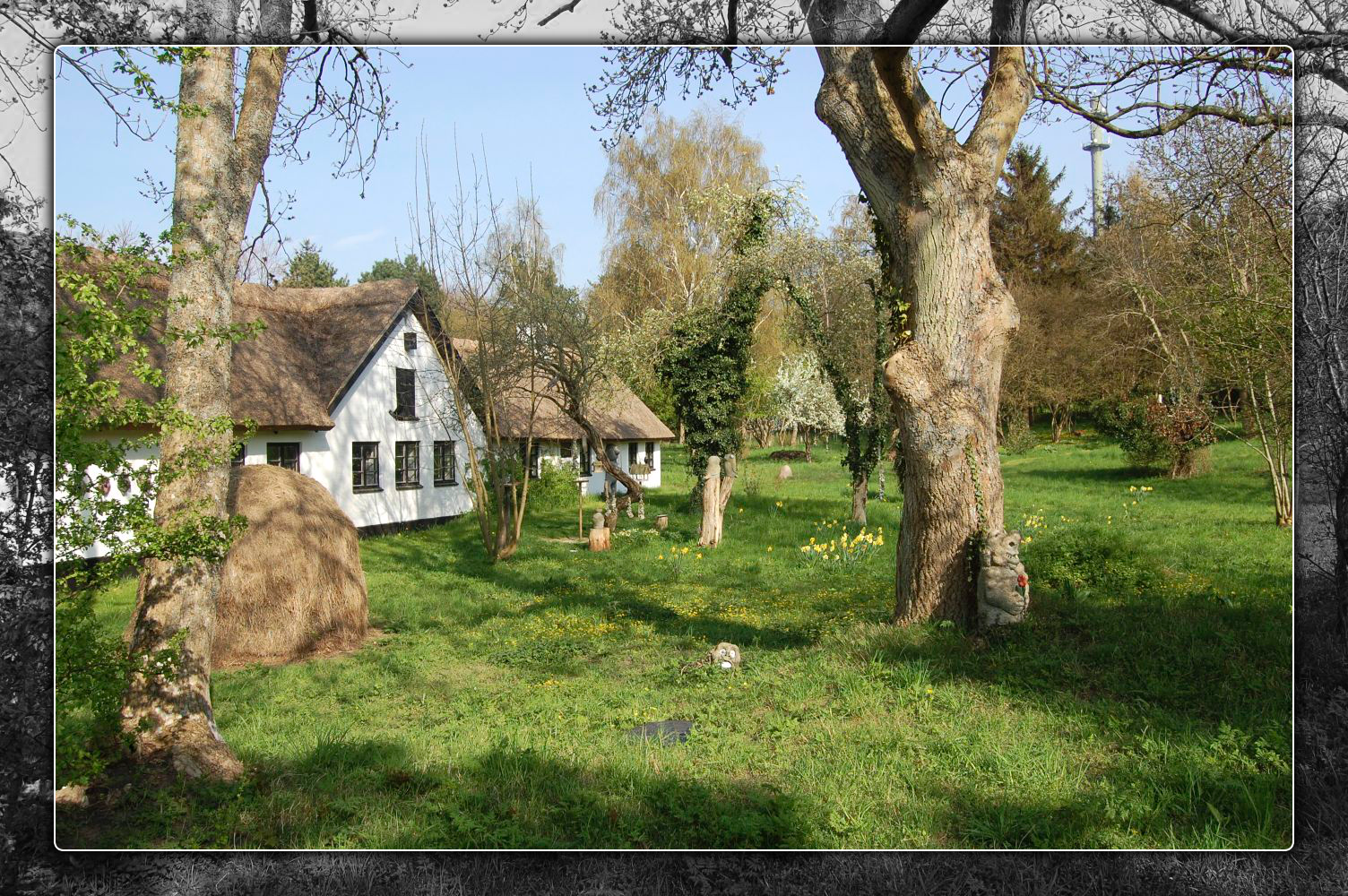

Reading the script the border width and height refer to an 'inner border' not 'outer border' so the default settings of↓
This will result in a black and white 'inner border' with a rounded white separation of 2 pixels

Just playing with B&W Borders script.
1. Image > Canvas Size, w+40, h+40, center.
2. Layer to Image Size (red dots).
3. B&W Border script, bw20, bh20.

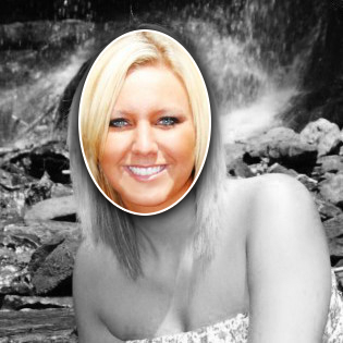

Graechan wrote:
It's easy to modify so that it recognizes a selection instead of the borer width and height settings
I'll try and contact the author to see if he can implement
I don't know how you were able to make that oval selection Graechan. I tried making a selection and the script ignored it.

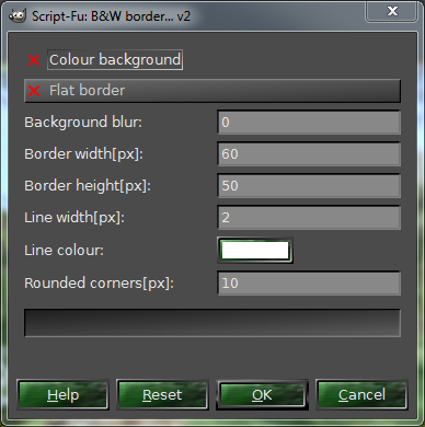

This is the script modified to recognize a selection
BW-border-ENG-v2.scm [3.55 KiB]
Downloaded 131 times
