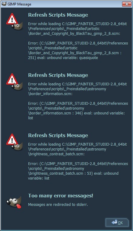

I am using last Samj build (with mathmap ) and i noticed a problem with many script fu that will not show up in the menu or will not work
Refreshing filters many will give errors as
but all the script do work with gimp 2.8, it happened the same with a recent script to Saulgoode viewtopic.php?f=9&t=6529
according to Saulgoode
'unless' is a macro that should be defined in your script-fu.init file (located in the same folder as the rest of the default scripts). Double check your configuration and your download (the script runs fine for me).
The file is where it should be ...maybe for some reason is not found by gimp..
any idea how to fix ?

My gimprc file !! Dumb me it was a stupid problem with my preferences : 1 of the default path went lost! :roll:
i believe solved now, i am going to reload gimp to check
