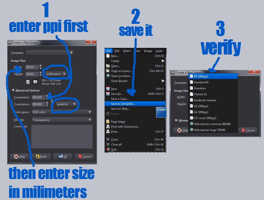

To keep things short and simple, let's say you want to print in A4, 300 ppi quality, ok?
Then when you'll open gimp, choose this:

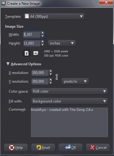

And it's easy to set up more of them, just take note of sizes in milimeters of the format you want (list of format) and create your template, here is how you create B5 300ppi template:

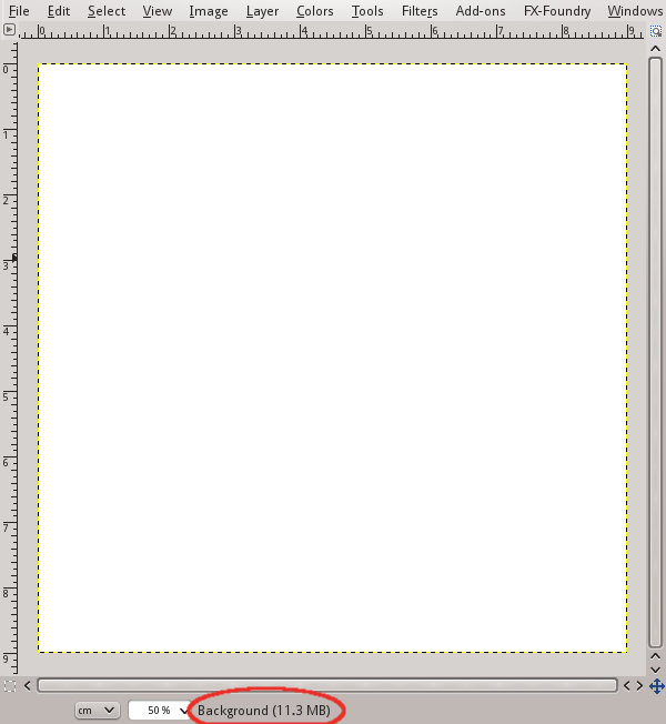

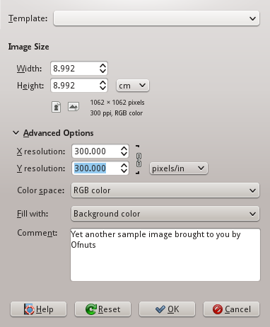

Wondering what you are doing wrong/ To create a 9x9cm image at 300DPI you just do:
and you get:
How many pixels is your image?
