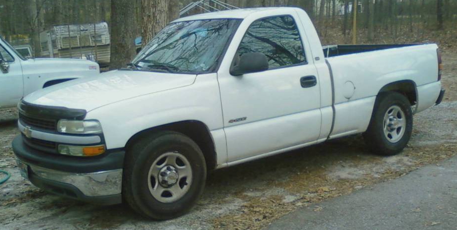

I am working on a photo. Well i think at one point i knew how to do this. But for some reason i can't remember how. In the picture below i want to change the truck from white to black. and have it look like the truck is truly a black truck. I have done this with a layer mask on a different picture and set the layer mode to overlay but it was from a off color orange to a red orange. but doing that same thing to this picture doesn't seem to work. it just comes out as a darker white. here is the photo. i want to turn the truck from a white paint job to a black paint job.

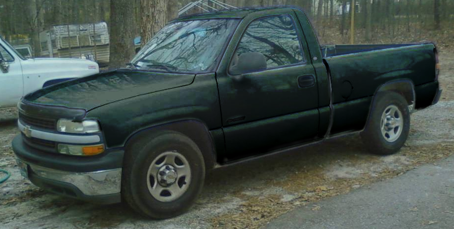

Here's my take. Had I put more effort the results could have been much better.
So I think it's doable.

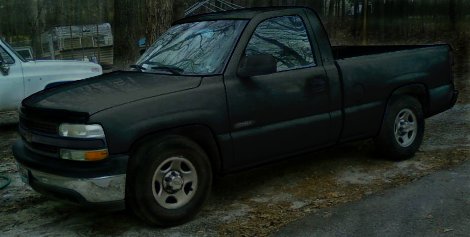

Best I could come up with today - looks more like a cartoon car though. Was supposed to be black 'glass' so don't know how the white lines got back into it.
I tried colourizing black and colour to alpha but that didn't help much at allImage

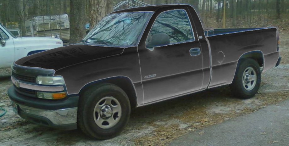

This is the most convincing try, imo, reducing the brown tone with a black car photoref to go further maybe.
Note: white balancing the photo sounds also a good idea to erase those green tints.
