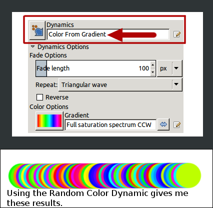

GIMP Manual v2.8 shows that there is a selection in Dynamics that is Color from Gradient. I do not have that option. The option I do have is Random Color and that gives very undesirable results when I want a smooth gradient look. Does anyone else have that problem?
Here is the section of the GIMP manual with the information:
http://docs.gimp.org/en/gimp-concepts-gradients.html
The image is part of a screen shot from the manual and I added what I get when I use the Random Color option.

I do not have that preset either, and I can't figure out why the GIMP manual refers to something that actually doesn't exist yet or anymore. :puzzled
Nevertheless, this kind of setting can be easily reproduced in the following way:
  • create a new Dynamic through the special button placed in the Paint Dynamics dialog; if you want, rename this preset to "Color From Gradient" or something similar;
  • in case, double click on the newly created preset in order to activate the Paint Dynamics Editor;
  • select the "Mapping Matrix" item on the drop down menu and turn on the check box connecting the "Color" row and the "Fade" column;
  • lastly, in the Tool Options dialog, make sure to set the "Repeat" option to either "Triangular Wave" or "Sawtooth Wave".
As you will be able to verify, the effect resulting from this method should substantially be the same one which was achievable with the comfortable "Use color from gradient" option available in GIMP up to version 2.6. :)

Just set Color to Random in the Mapping Matrix box for Dynamics_Off preset and it will be adding colors from the chosen gradient.
GIMP manual isn't 100% up to date, BTW.

The image in the OP tells me you used Random Color dynamics, O!
It's different from Dynamics Off preset.
The method I suggested works for me anyway.

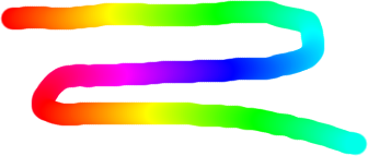

I just tried that and this is what I got.

I tried it your way, kite. Started with Dynamics Off preset and got the same results as I did from Random Color.
Here are the results I got with the tutorial.
OK, sorry, my bad, O!
I see what you mean now! You want smooth color blending brush stroke.
Cool tutorial! Thanks
