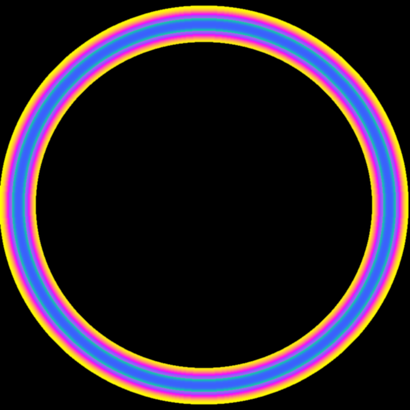

You need to create a small gradient source before create a selection (don't have to but best to do that selection on another new image). So, you need two images. Your gradient (small object) and your target where you make the selection that you want the gradient to follow. The fact that you see the plugin means that you have Python installed properly by the way Molly. Below's the sample gradient image that I created and the result after running the filter. :)
sample_gradient.png [ 804 Bytes | Viewed 3713 times ]
