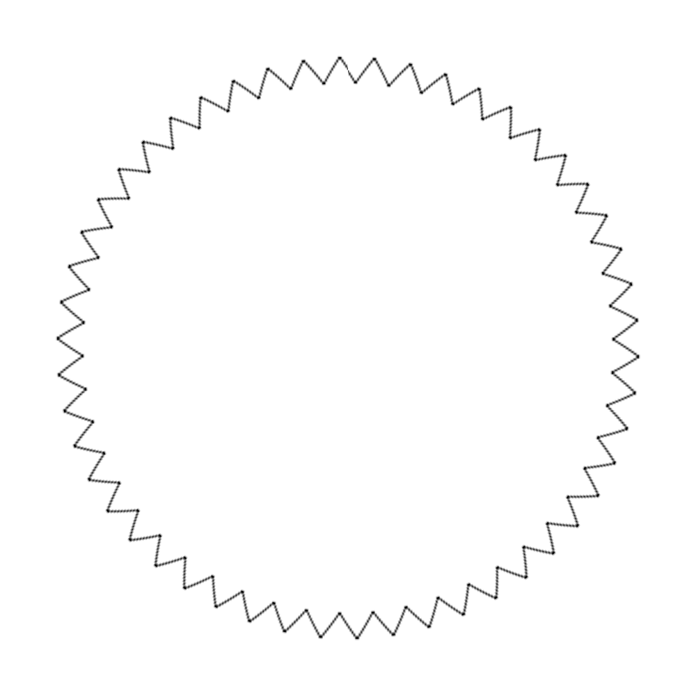

Needs more work, but I created a trangle wave plot (used a Shape Paths Script-fu for that) and the stroked the result and then ran Polar Coordinates filter for the result. :)

You could also run Star in Script-fu - Shape Paths, and make as many points as you want or make the points as shallow or deep as you want, in far less steps.

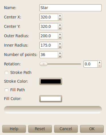

You could also use "Filters->Render->Gfig". (After drawing the star with the Star Tool, switch to the second "Hand" tool to move the anchor points.)

Wow I never used gfig until now, and I think I'm gonna need a lot of practice with that particular filter to get an effect like the award.

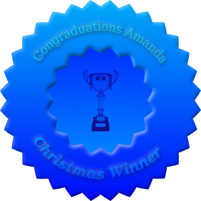

ok I got the hang of it now, well somewhat, thanks peeps!
