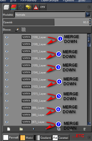

I have a file image.xcf with 100 layers, i manually subdivide all layers:
Layer2-Layer4-Layer6-Layer8...Layer50
and save 2 files
1.xcf
Layer1-Layer3-Layer5-Layer7...Layer49
2.xcf
after i merge down Layer1 with Layer2, Layer3-Layer4, Layer5-Layer6....Layer49-Layer50 with your plugin interleave layers.
Is possible with your plugin interleave layers merge down alternate layers without create 2 images as on image attached?

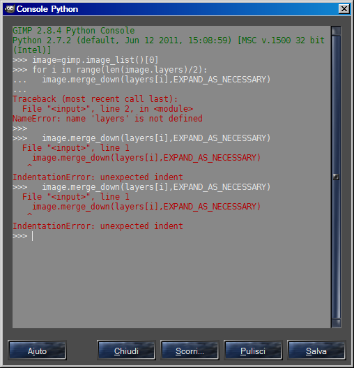

opened my files, python fu, console, copy-past your code, enter...nothing happens...i obtain these errors
For sure i'm inexpert about python-fu and i'm committing mistakes, can you help me? Thanks.

Sorry, not layers[i] but image.layers[i]... and you can put the for loop in one line:
image=gimp.image_list()[0]
for i in range(len(image.layers)/2):image.merge_down(image.layers[i],EXPAND_AS_NECESSARY)
Executing it will list a bunch of layers ('<gimp.Layer 'Layer copy #31'>')... if you did it right these will be the bottom ones, which are left in the image.
PS: the beer is on me :)

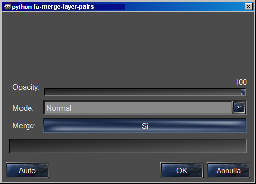

:tyspin Tried your script and works well, renamed all layers with script LayerGroups and merging down as i requested.
:oops: is possible add to your script Opacity and modality of merging as on image?

PostPosted: Mon Sep 02, 2013 11:26 am  (#10)
There you go
merge-layer-pairs.zip [1.33 KiB]
Downloaded 156 times
