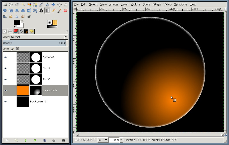

The following corresponds (somewhat) to the first ten steps of that tutorial.
  1. Create a new image 1600x1300 and fill the Background layer with black.
  2. Use the Elliptical Select Tool :elipse to select a circle that fits within the image (hold down the SHIFT key after clicking to make the ellipse perfectly circular).
  3. Create a new transparent layer and name it "Blur30".
  4. Add a layermask to the new layer, initializing it to the selection.
  5. Duplicate the "Blur30" layer and change the name of the new layer from "Blur30 copy" to "Blur17".
  6. Duplicate the "Blur17" layer and change the name of the new layer from "Blur17 copy" to "Spread41".
  7. Set the foreground color to white.
  8. Activate the "Blur30" layer by clicking on its thumbnail preview in the Layers dialog.
  9. Perform "Edit->Stroke Selection..." with a Line Width of 6.
  10. Apply a Gaussian Blur with a Radius of 30.
  11. Activate the "Blur17" layer by clicking on its thumbnail preview in the Layers dialog.
  12. Perform "Edit->Stroke Selection..." with a Line Width of 4.
  13. Apply a Gaussian Blur with a Radius of 17.
  14. Activate the "Spread41" layer by clicking on its thumbnail preview in the Layers dialog.
  15. Perform "Edit->Stroke Selection..." with a Line Width of 4.
  16. Apply a "Filters->Noise->Spread..." with an Amount of 41.
  17. Apply a Gaussian Blur with a Radius of 2.
  18. Set the foreground color to orange (#FF8000).
  19. Create a new layer fiiled with the foreground color and name it "Select Circle". Position this layer just above the Background layer in the layerstack.
  20. Add a layermask to the new ("Select Circle") layer, initializing it to the selection.
  21. Set the FG/BG colors to their defaults (foreground=black, background=white).
  22. Double-click on the Blend Tool icon :blend and change the Shape of the blend to "Radial" in the Options dialog that appears. Also, click on the Reverse icon :reverse (the gradient should be "FG to BG (rgb)").
  23. In the Image window, drag a Blend stroke from a position halfway between the edge of the circle and its center at about the 4 o'clock position to a point opposite the center in the 10 o'clock position (if you are unhappy with the result, UNDO and try again).
At this point your setup should appear similar to the following (the mouse pointer shows where I started my Blend stroke in step 23):

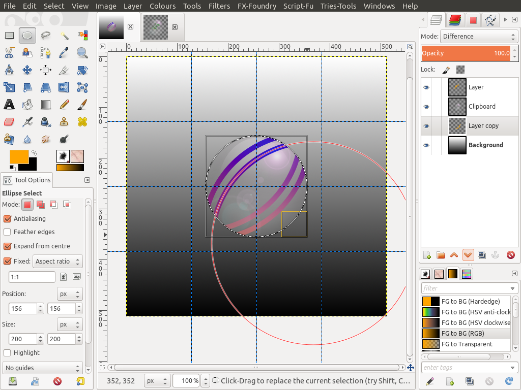

Thought I would share one way you could create the orange stripes, If you know the original diameter of your orb then create a path twice the size, In my example below the orb is 200px in diameter so I have created a circular path 400px in diameter. Then using the move tool, make sure it is set to path move and position your path, stroke path using desired settings, I selected the orb first so the path tool wouldn't stroke outside of the circle.
I finally duplicated the two lines I had created and rotated this new layer by 180 degrees and positioned under the orb to create the rear lines.
