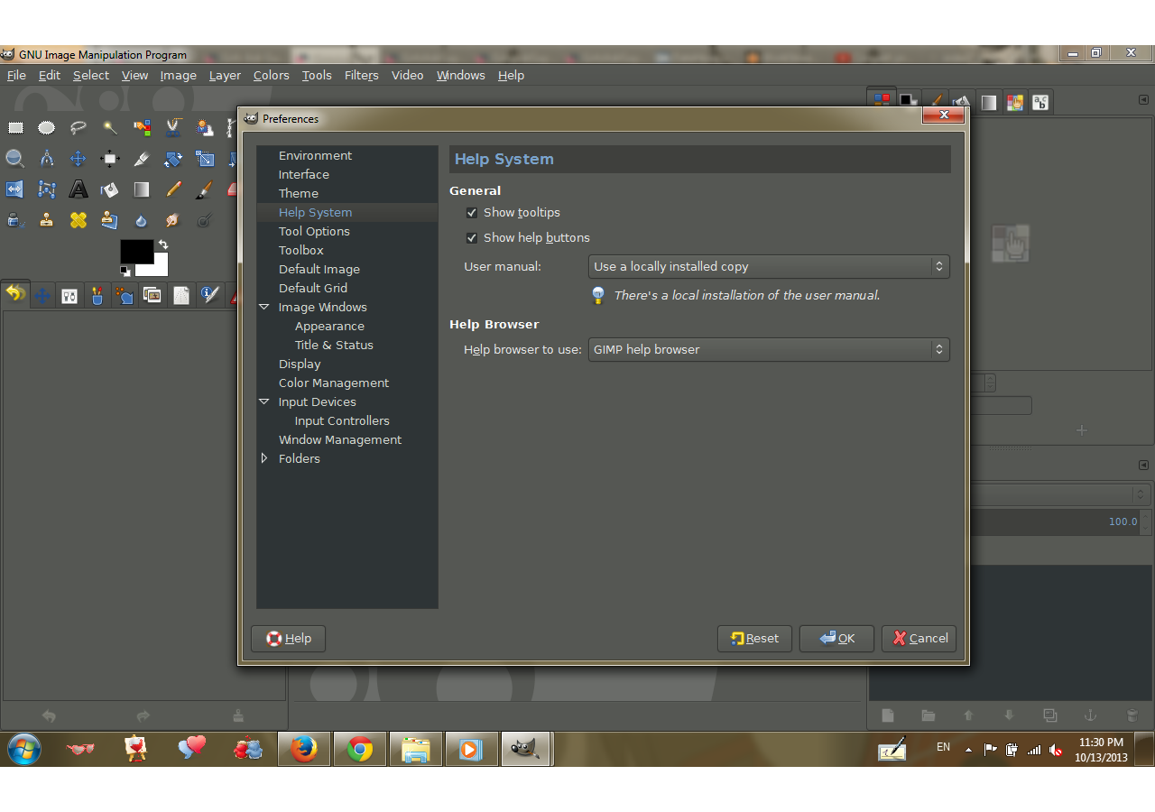

Here are some screenshots showing that python-fu is missing from the filters menu and that despite having GIMP Help installed I can't browse it.
File comment: Partha's build showing that despite having GIMP Help installed I cannot view it.
File comment: Partha's build Edit Preferences dialog showing I have GIMP Help installed.

 Post subject: Re: Partha Build Missing Python-fu
PostPosted: Mon Oct 14, 2013 12:44 am  (#5)
effykingly for the help issue I'd suggest switching to the external help browser instead of the 'Gimp Help Browser' in your help preferences,as for why it has no python do you have a python Folder here↓
Note! these folders and files will slightly differ from yours
but your portable should have a python folder

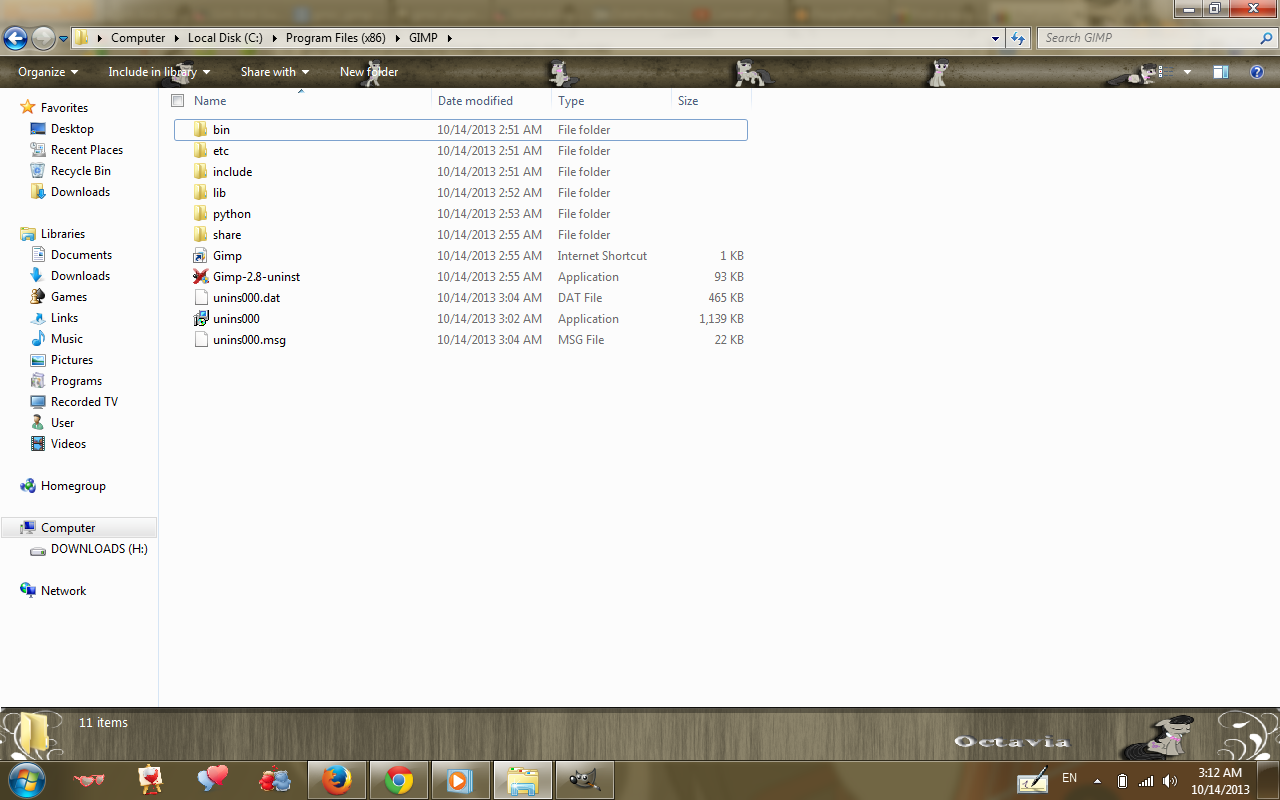

File comment: My python folder
PostPosted: Mon Oct 14, 2013 4:30 am  (#7)
Joined: Mar 14, 2011
Posts: 998
effykingly wrote:
Okay so I'll have to use the web browser for help and yes I have a python folder. I'm using the installation not the portable version of GIMP 2.8.6 32-bit version. I know I have the Windows 7 64-bit version however I've used the GIMP 2.8.6 64-bit version with the same issues- no gimp help browser and no python-fu so I thought to switch over to the 32-bit version as I find 32-bit versions tend to work better.
As Graechan said, please use the Gimp manual from docs.gimp.org. Building the help browser is a pain.
Python can be finicky animals. Btw, you don't need the 32-bit Gimp since you have a 64-bit machine and my 64-bit builds have 64-bit Python incorporated.
Please do the following:
1. Open a commandline window.
2. Assuming you installed Gimp at C:\Program Files\Gimp-2.8\, please type in the commandline Window:
cd C:\Program Files\Gimp-2.8\bin
.\Gimp-2.8 --verbose > C:\Users\[yourloginname]\gimp-run-2.8.log 2>&1
Now you can shut down Gimp or open an image or something.
After you shut down Gimp, send me the gimp-run-2.8.log file that was generated.
Thanks,
Partha

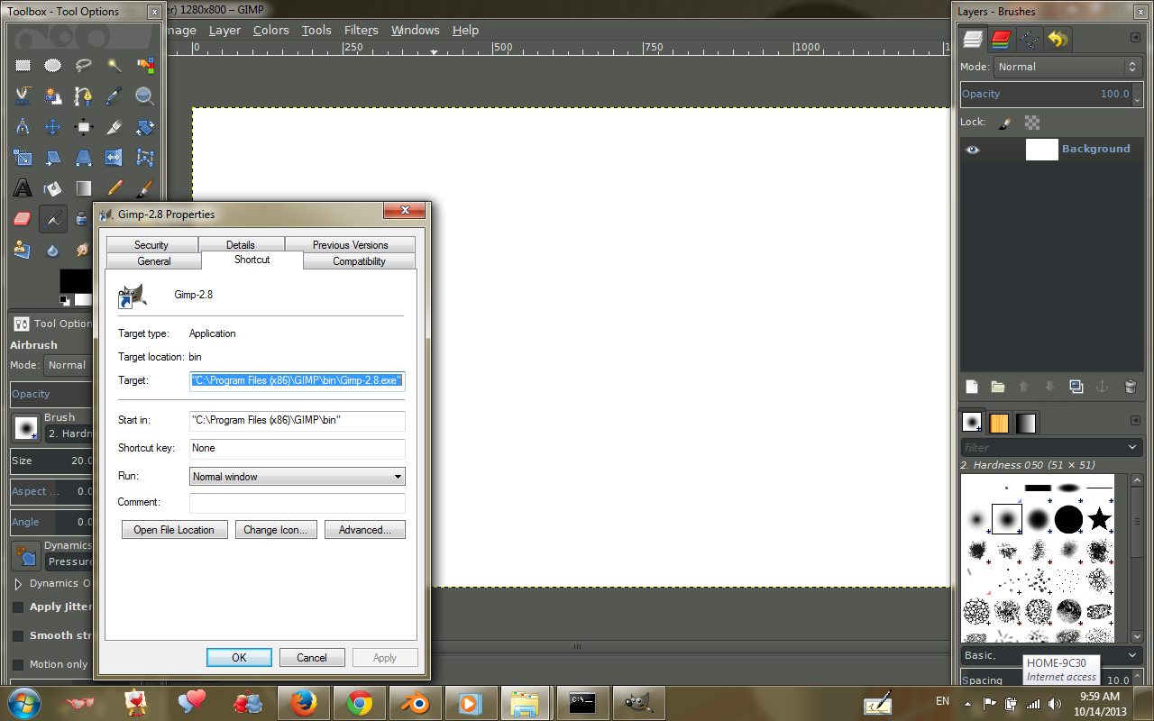

Ok, Right click that Gimp icon in the Start Menu then choose properties.
Check that the 'Start In' points to the same folder the 'code' is using. If not set it to point to 'C:\Program Files\Gimp-2.8\bin'

The 'Start In' points to the same folder the 'code' is using and I have two entries in the Plugins Folder from the Preferences dialog.
File comment: The Preference's Plugins folders
File comment: Start menu properties showing the start in points to the folder the code uses
