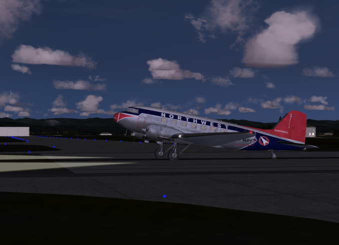

Basically, I'm trying to repaint an aircraft for the Flight Simulator 2009 (FS9) I've attached an image of one I did (repainted) earlier that I've put on a couple of FS related sites
Basically, I've got the template, ( first example attached) which I repaint. I then save it in GIMP as a .png...move it to another programme, which changes it to a .bmp format. Then, I load it into the programme (FS9) as, for example bm_fuse_1_t.bmp It then appears repainted as a new aircraft, which is 'flyable.' (hopefully)
What I'm trying to achieve is to bring about a more realistic base texture, highlighting panel lines, rivets, window frames etc. I've used the Bump Map...and that seems to work OK, the Normal Map could give a better effect I think. Your Q re: 2D or 3D? I'm assuming it's 3D....but, with my limited knowledge of these things, I wouldn't bet on that being right :oops:
Hopefully, I've explained why I'm trying to do...apologies if this a little 'long winded' but, I'm on a steep learning curve with GIMP..even with the basic technical stuff.....which I keep stumbling across.
