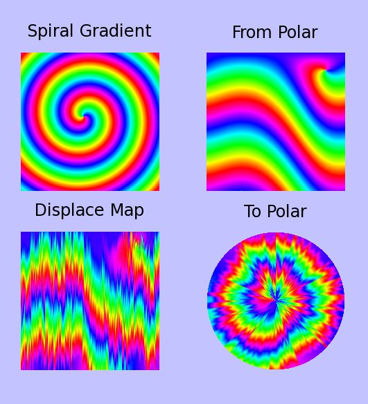

Needs some experimentation but here are some thoughts that may be useful:
Create a displacement map consisting of vertical striations
Create a spiral gradient and then apply the displacement map to that spiral in rectangular coordinate space.

How did you get those long, smooth curves in From Polar?

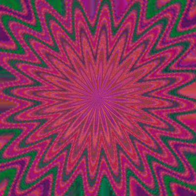

How about:

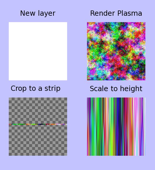

To make it I began following Saul's guiding hand. I started with a 400x400 white image and added an alpha channel then rendered a plasma . Then I used the Filter > Distorts > Wind with settings of Wind, Left, Both, 7, 100. Next I selected a 10x400 px rectangular selection from an appealing area. Next I cropped to my selection, and resized my canvas back to 400x400px, but did not resize the layers. Next, use Layer, Scale, Break the chain and set to 400x400px. Select None. Now I used GMIC > Deformation > Twirl to give me a reasonably tight spiral with output onto a new layer, now select the new spiral layer and run GMIC > Deformation > Flower. I set the # of petals to 20, and you can get variations by changing the amplitude of the petals. It doesn't quite have the fuzziness at the edges of the petals as the others I've seen.

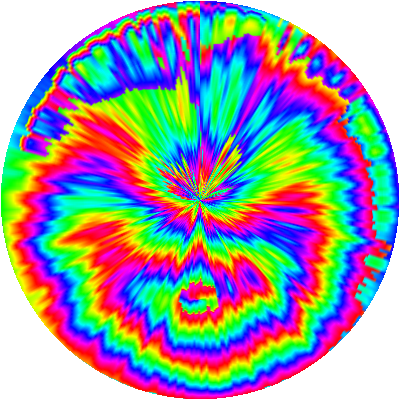

No clue what I was doing here ...

That's pretty cool, Mike!
I used a "circle depth percent" of 100%.
Oregonian wrote:
Even though I didn't get those long curves in From Polar, I went ahead and gave it a try.
As long as you use the same "circle depth percent" for both going from polar and going to polar coordinates, it shouldn't matter too much what the actual value is (I think 100% will preserve the most quality though).

saulgoode wrote:
I don't get any curves. All it does is slant the straight lines. Changing the offset angle only moves the image around, no curves.

O:
1. You have to use the spiral mode in Blend.
2. Run the Filters - Map - Displace, (use Polar, not Cartesian)
3. Run Filters - Distorts - Polar Coordinates (Polar)
HTH

I did use the spiral blend. I just don't get those curves in the From Polar process that saulgoode did and no matter what I do, I don't get them.
I just don't understand why I can't get the curves in the Polar Coordinates for the From Polar that saulgoode did. It just straightens out the curves of my spiral blend.
 Post subject: Re: Create this Gradient Effect?
PostPosted: Fri Dec 31, 2010 8:07 pm  (#19)
Ok, one question: Did you center it? I just centered my spiral and polar coordinate bent it straight. So, I offset the spiral shape away from center and presto, it worked.
Aha! And I was so careful to center my gradient using guides to do it. Now my From Polar curves along with the best of them.
